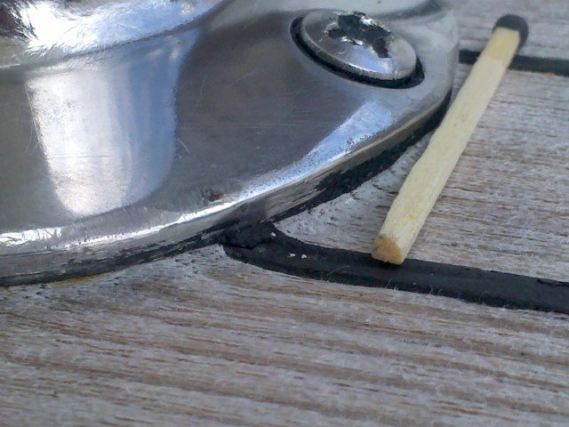

    The deck measures just under 3/4 now after LIGHT sanding. A number of planks have been replaced and were not good sq planks. I've had some good shipwrights opinions. The problem is the continued discovery of more compromised planks and the effect to the rest of the deck. It is what it is.
    Sure looked good at first. Puddles should have givin it away. Now we know.

    The pics
    The pics posted are older, and of planks now replaced. The good photos are to big to send other than by email. They tell even more.

    I see damage that appears to have been done by over sanding. Wouldn't consider it an OA problem or manufacturer's defect. Do you have a captain or detailer? If so, I'm surprised that they didn't stop you. Or was the sanding done by them? Was it done with a block, a hand or a power sander? It doesn't look like a block was used. If it was done by the detailer you should talk with them about that damage. When you said earlier that it "measures just under 3/4 now", I assume you don't mean inches. Correct? What you usually find these days is about 1/4" or less. One look at that should tell you there's no wood to spare. Some of the other things you mentioned (except the rubrail and the paint) are more troubling though.

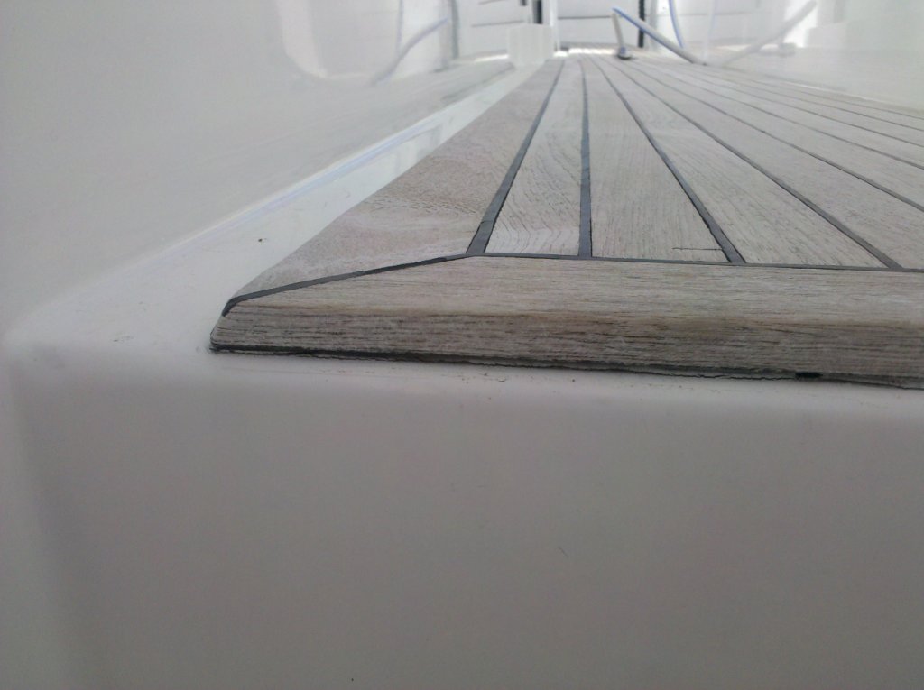

    Thicknes
    The decks thickness messures 1/2 to 3/4 inches, closer to 1/2 than 3/4.

    The messurments are after my sanding. Since we all agree the decks may have been thin back then, then what did I start with. Probably 3/4 inch.
    To be clear, I watched the sanding, and the black just started growing in some places. Little dust and take down. With much of the deck it just took the surface off nicely. But, throughout the boat super thin spots appeared, filled with black cauk and epoxy of some sort.
    Much of the deck looks like the same decks on all the OA's in the P Beach show.
    I just got numerous planks that are chiped, split and not solid just under the surface. The problem is the water getting under these bad boards. Trained or untrained eyes agree.

    Thanks for your thoughts. The sanding was belt, lightest grid, 1/16 inch take down, hardware not removed, you can see in the pictues the take down. Look close and let me know how much it looks like.

    Maybe not 1/16
    Note picture for thickness... not much sanding

    The deck after sanding
    These decks should (and per OA) be lightly sanded for maintanance annually. I did it once in year 3. As you can see there should be some life in these decks before you expect to hit backfill of epoxy and chauking. They look now after the sanding as nice and thick as their new boats with the exception of the thin areas scatered through out.

    That's not from sanding, thats from cleaning the decks every few months with the wrong products. Using a 2 part cleaner like Snappy probably removes 1/32" every single time you clean them.......that is a lot of erosion to the decks if you look at the origional thickness. The products I used to clean them takes off no teak, then you might have to sand them every 3 years. It's not the builders fault, it's the person maintaining the boats fault.
