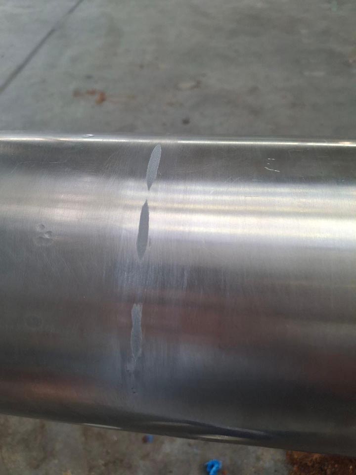

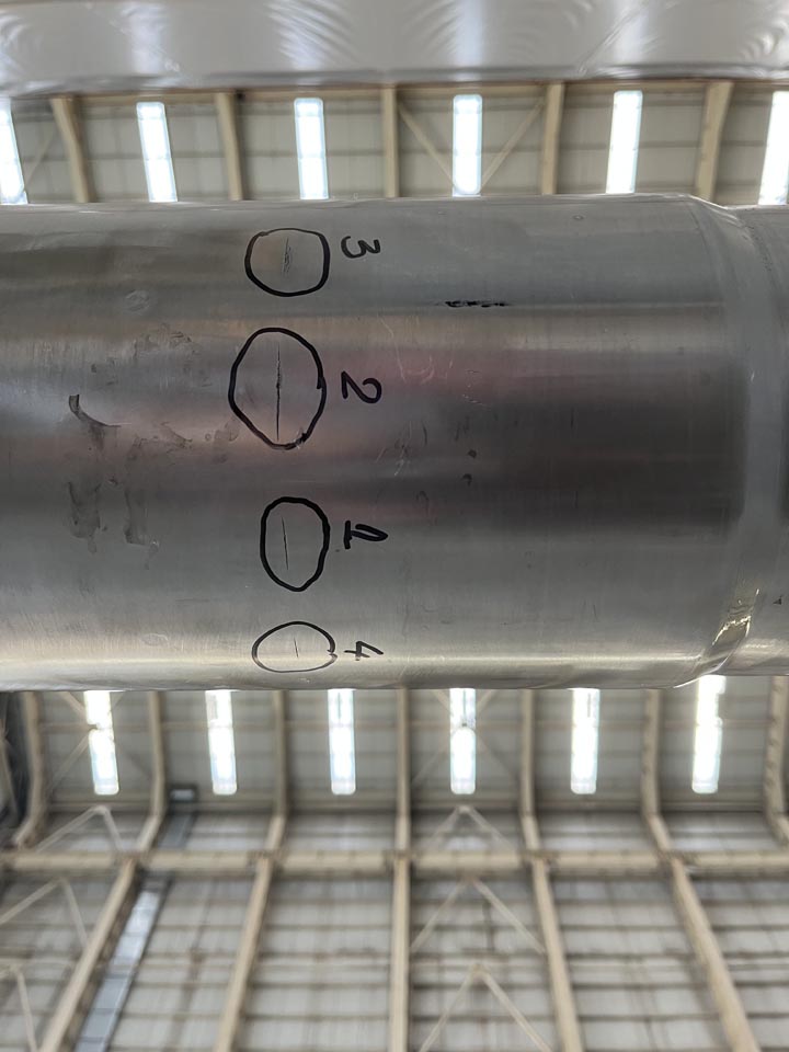

    Dear colleagues,
    imagine you have CPP propulsion shaft OD 200mm with bore 80mm.
    Shaft has been found cracked exactly below ST seal assembly. ST is water cooled system. Cracks found deep around 1mm. Shafts are 20+ years old.
    Class has approved cracks repair by Belzona and shaft surface was checked only with regular NDT test. For example the Eddy current test never was approved by management for micro cracks check below surface cracks.
    Please see photos before and after repair.
    Your professional opinion would be highly appreciated!
  2. Capt Ralph
    14,542
    Interesting crack pattern.
    It goes all the way around? Reminds me of but welds joining pipe together,, failing.
    Oh wait,, CPP? Control rod down the middle?
    Was the shaft later x-rayed to ensure the welds went deep enough?
    I fear there is a problem with shaft support and sudden application of heavy torque loads.
    I am not a professional in this matter, just swamp logic; I would have no faith in that shaft.
    If it must be re-used, ease up on the rate of loading with your fingers crossed. ;)

    Belzona does nothing for the strength of the shaft. All it is doing is helping to provide a continuous surface for the seal to ride on. Is the yard doing the work class approved to make shaft weld repair? Any certifications need to be specific to the material type of the shafts and the shaft size. Weld repair involves grinding out the crack, pre-heat, weld, post-heat with a specified heat reduction taper and then machining. We do shaft weld repair all the time and hold many class Certs. You could also explore spray metalizing which is now an approved process by ABS and NAVSEA. I think DNV accepts this now as well.

    Thanks for your comment. I absolutely agree with you regarding repair, but obviously somebody loved quick repair while crew can't do anything about it. If you take into consideration this is CPP shaft with bore 80mm on shaft OD 200 mm, it means 60 mm shaft wall thickness. I believe any serious class especially IASC class would scrap this shaft. Bat in these days IACS is not any more what used to be.
    This shaft under load especially in bad whether easily can snap off and sink vessel and crew. This case telling you how is Yacht Industry polluted by any kind of dilatants.
