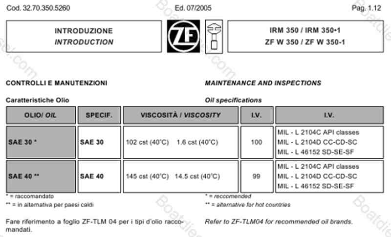

    That is what the trans had in them from the commission so I didn't want to change. Since I only put on 200 hrs or less per year we change oil every 2 years maybe a little less.
    Skip

    It shouldn't have a multigrade. I don't know of any transmission where a multi-grade is recommended? If they're ZF or Twin Disc they're supposed to have straight 40W, or straight 30W in cold climates.

    They are ZF. Maybe the next change will go to 40w. Will that cause any issues changing weight? Should I use synthetic or regular Shell Rotella 40w?

    Yes I have been using Delvac 5-40w in the ZF350A since commission (06).

    Who has the factory ZF 350A manual out there. I can not find one. Need oil and second choice specs. I'l send a note to Texas.

    I would call ZF North America and ask them. I was told not to use a multigrade in their gears and to use straight 40W.
  10. Pascal
    8,940
    actually, multigrade is ok . I pulled the manual for our BW190s (on 3412Es) and then looked up the updated list on line
    http://www.zf.com/media/media/en/document/lubricantslists/TE-ML_04.pdf
    As you can see every tranny that uses regular oil (not ATF) either 30 or 40 can use either straight or multi. Only a handful require straight 50 only

    It's a tough decision to make skip. Keep what oil you're using and that seems to work. Or change years later to what the book seems to state. If it's still crystal clear as it was new, You may want to drag your feet in changing it.
    As Skippy J said also, call ZF. Tell them what ya got, how well it's working and should you change.
    I am a big fan of synthetic oils, Just can't find the right stuff for my 36 year old DDs & TDs.
