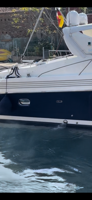

  10. Sarnico
    Sarnico New Member
    Jul 11, 2022
    45
    On the 58 it is 100% also exhaust on the side (ca. 150 mm dia) plus big underwater exhausts. See pic, you can also see some smoke there... Lovely turbo noise from those when manouvering.
    mapism likes this.
  11. Capt Ralph
    14,600
    Mostly to release idle exhaust pressure, greatly reducing gurgling from under the boat. Just a little water/steam comes out.
    The large block chevy (LBC) , idled much nicer and had more um-pa in & out of gear while docking.
