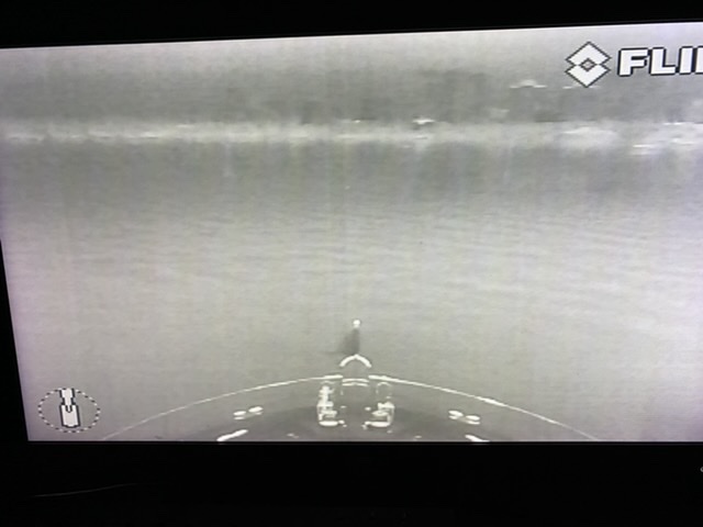

  6. Pascal
    8,938
    I took this picture last night to show the limitations of FLIR depending on conditions. Same view as posted before but on a very muggy humid night.
    day markers visible at a quarter mile on a dry night are barely visible at 300’

    Let me guess: in those conditions, didn't you actually see the marker better by bare eye?
    Of course, assuming to not be blinded by any helm lights, no glass reflections, etc.
  9. Pascal
    8,938
    Actually yes. On the way in, with the lights from the city reflecting on the water, even in an enclosed PH it was visible from a longer distance. On the way out, not so much :). That’s why spotlights come in handy once in a while.
