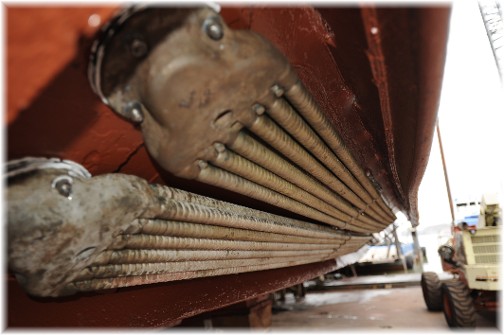

    I've heard that many of the commercial and offshore ships working the spill have keel coolers (for those that don't know, and I was one of those for a long time, that's a closed engine cooling system with cooling tubes that run along the keel, so no raw water intake into the engines).

    Here we go again ... 99 percent of marine engines other than outboards are not raw water cooled. The raw water goes through a heat exchanger. It moves faster through the heat exchanger than it does past the tubes on a keel cooler.
    There is no raw water going into the engine cooling passages on those boats. If oil was somehow drawn into the raw water inlet it would be very quickly flushed out of the system and cause no problems. There are about 50 boats working around the site of the blowout, in the rising plume of oil. They use seawater to cool the jacket water via heat exchangers, they are not dropping like flies due to oil fouling.
    To be perfectly clear, there is more chance of losing cooling efficiency due to oil fouling of a keel cooler than a tube and shell or plate heat exchanger because the rate of flow past a keel cooler is very slow and at some speeds the water may even be stopped or moving forward along the hull, in that situation oil can stick to the tubes and reduce cooling.
    The sky is not falling on boats, the oil is not destroying engines. The oil is not several feet thick and it is not lurking as a layer of tar just beneath the surface.
