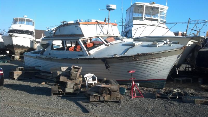

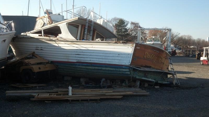

    i took two photos of the Pederson, which is a 45 footer, which i originaly said 42 ft. I got a little closer and as you can see, shes done. I was speaking to the builders son today, he mentioned it was the first "big" boat they ever built and was built for an oil guy. he wasnt sure how they ended up with it from the owner, but did remember his dad and the owner were good"drinking" buddies. So with that said i am sure you know how that went!!!! Hope all are well.

    I dont know,, I think she can be rebuilt, she didnt sink,,it looks to be a matter of the windshild being rebuilt , its wood, woods ezypzy. Looks like the roof is in tact, shouldnt be that bad. She's a real looker, whats her drive train?

    i should have gotten some more pics, but the hulls are caved in and engines are dislodged from stringers. truthfully it needed TLC before our freind Sandy stopped by. By the way how are you getting along? Any progress?

    A heavy canvas tarp pulled under the hull would keep enough water out for a 6" pump to empty the water. You have to get in the water and plug as many thru hulls, port holes and exhaust pipes before the pumps will catch up. If they lifted that boat very much with it full of water you can just about guarantee that the planks didn't stay on. The weight of the water will pull the fasteners out of the frames. Especially if that bottom is on the soft side. As simple as it sounds boats aren't built to hold water.

    To bad about the Penderson being caved, that was a fine lookin boat for sure As for my Three Belles, and your coment dsharp, that sounds about rite, I wish a bag would do, the crew the USCG brought in had to small of a crane and a single diver couldnt patch the hole by himself and and only made it bigger. I was not allowed to do anything but watch. they had a 90 barge but a tiny crane. They removed all fuel and contaminants and dropped her back down. Its still there, I have a guy with a bouy tender that will come in and bring her to the yard across the way where we might get permission to scrap her but thats 5k. If and when, I will do all I can to salvage the Detroits within hours of her getting air but Its just part of the whole sad story . My ex wife's house took a hit too and with her 95 yr old father to care for, Ive been busy taking care of them too. New furnace, HW heater, demo and mold removal , I feel like I been rode hard and put up wet. and now Im broke too. Its not so unfamiliar to so many people who have suffered through this storm.

    George, thanks for the pictures and the status of the Pederson. One thing that could be done is too cut off the transom and make a nice bar. I have a 1965 Owens transom that I took from a boat that was being cut up and will make a bar for my deck at home.
