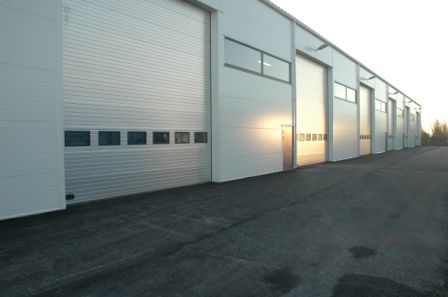

    The latest building at the shipyard is just finished and includes a test basin so we can check for leaks and engines can be started up also now when the sea is frosen over.

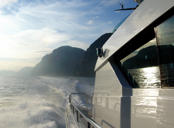

    Thanks, I am not there myself but I got a report tonight after they launched the boat, the show is in the water since they have the North Atlantic Gulf Stream just outside Bergen. (In Stockholm we have ice now).
    They were out in pretty rough seas and tested out how she would perform in high speed. The guys were very impressed when she was flying in 47 knots and landing straight, smooth, silent and dry after each jump! Not bad for a rookie like me to have achieved such a hull design...:)
    I hope to get some pictures the coming days...

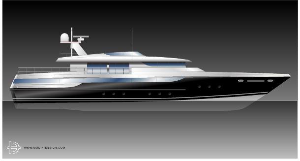

    I was asked if I had any big "open" in my portfolio and in the context of open as in soap designs, I had not. So I made a counter proposal of an open with a more classic design, still pretty innovative.
    She is 45 meters and the whole maindeck is enclosed, with an open aft deck and flybridge on top.
    The stern is pretty high and is hiding the biggest garage you have seen, partly on maindeck with surrounding windows so you can use it for a party when all the toys are launched.
    Forward on main deck is a cosy full beam salon and further forward the owners cabin (under the bridge). Below are four guest cabins and forward is the crew area.
    On the bridge deck is a large lounge with floor to ceiling windows including dining area and galley as well as a spacious bridge with observation area.
    The transom is folding down to a beach and to launch the tenders there is another hatch going up. This whole area outside/inside will be high enough to not cause any risk if water should go in and thanks to the big side windows also far from the cave feeling of other yacht garages.
    When all is closed, the yacht is better protected from unwanted visitors than those with open stairways from the platform...
    On the fore deck is space for sunbathing, jacuzzi and sofas so she has a lot to offer if you like to have an "open" yacht without the high maintenance exterior of a soap design...:)
    Propulsion and speed requirements are still to be determined.

    Normally I'd blink a lot at an open with a Portuguese bridge. But this works well with that vertical front window. Pretty cool Lars :)

    :eek: i'm not more impressed - i'm speechless....
    could you show the layout, so we can see how you mean it with "biggest garage you have seen" ? ;)
    this is the best yacht after my all-time favourite, the DC 66 (in tread one of your designs)
    wow!
  15. AMG
    5,392
    Sorry Jannick, but I have not yet completed the GA. The garage covers a surface of 100 sqm and is 3 m high! Then there will be corners used for gangways and tools to lift the toys, but still plenty of space for all the fun.
    A built in Shadow boat if you like...:)
    Propulsion will most likely be diesel-electric with azipods and generators fitted under the forward part of the garage.

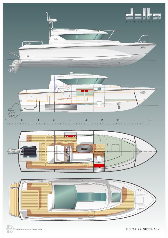

    D29 for November launch...
    Back to the production boats, the hull of the coming 29-footer will soon be cut out by the CNC-robot. This is the final renderings on this commuter based on the same design concepts as the 25´and 40´. The central steering position, passengers forward and the sliding moonroof from the 25´, fitted in a smaller version of the 40´hull and with a "Sidewalk" solution for easy access over the bow. She can also be used as a weekend cruiser for a small family.

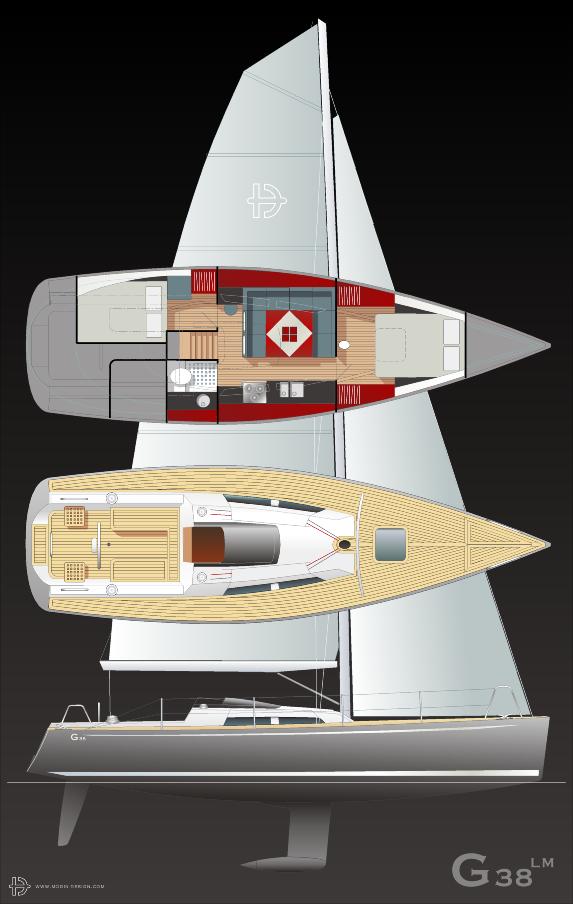

    G38 for 2008...
    This boat is coming closer to reality and I have looked into a rigging with selftacking jib and no fixed backstays so a high and wide mainsail can be used. This is especially good in our archipelagos where the wind is playing around between the islands. The interior is a two cabin, one head, with limited headroom in the forward cabin as the only compromise...

    hi lars, what about the D29, is it already launched and if yes, do you have any pictures of it running and interior ?

    Lars, is that G38 designed for production?

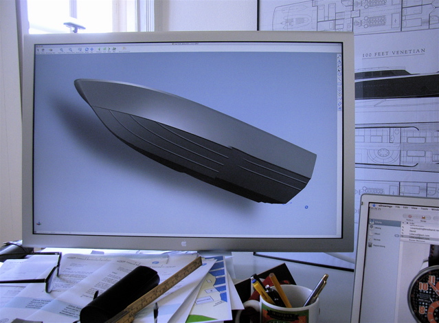

    Jannick,
    the D29 will be launched in November if we are lucky. Production of the plug for the hull will start this week, I made a few corrections to the bow shape last week.
    Kevin,
    this G38 is one of two alternatives, the other is more traditional and the producer has not yet decided which one is the right to launch. I would like to see this one, as the market is already flooded with Bavarias and similar family boats....;)
