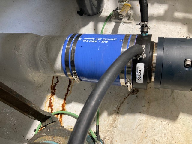

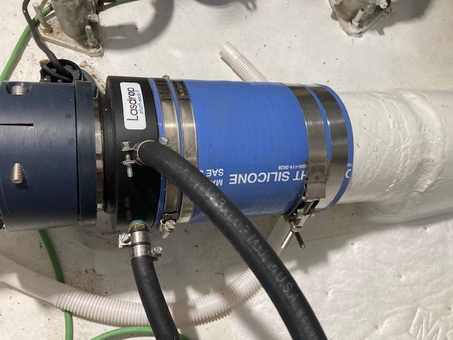

    My previous seals were plumbed the same way and I never had an issue either. I'm already seeing signs that the new port seal is failing again. I've got something weird happening here. And I don't have faith in these Lasdrop seals. Although the starboard side has been fine so I'm not really sure what's going on here; yet. You can the port seal bleeding some rust and some black carbon coming off of it. You can't tell from the picture but it is discolored like the other one was that failed.
    It pisses me off that I've had to haul and replace seals, especially given they provided zero guidance on how to plumb these damn things. Here's current photos taken yesterday of both seals.

    When I first was involved with dripless seals, the info at time of installation was that the reason for the forced water was that at speed, the cavity behind the seal would accumulate air (like station-wagon effect) and the seals would overheat. The purpose of the forced water was to eliminate air and allow heat transfer with water.
    On the last yacht I was running, it had PSS seals with plumbing from one engine only to each seal. While maintaining engine zincs, I found that the last heat exchanger in the starboard engine raw water circuit always had sea water in it well above the water level outside the boat. Since it made a situation requiring clean up, I explored the raw water circuit and found that the nylon hose nipple at the PSS seal was completely shut with salt! The yacht was on a dockside run schedule that I performed every two weeks (when not underway), and yet it clogged.
    Something else to explore is the possibility that the low pressure zone in the seal is drawing air from the plumbing itself. Perhaps a tee with a petcock or a flow meter sender in the cooling lines could be installed to verify that there is positive water pressure at speed.
    Another issue is that the hose barbs should be at the top of the seal, as in the case of your starboard seal, there is potential for an air pocket at the top of the cavity.

    We pulled the hose off the seal coming from the engine and fired them up and there is significant flow going to the seal. We also verified no plugs, obstructions or kinks in the lines. To your point d_meister, we could be getting some type of air pocket or weird pressure differential through that crossover line that is causing an issue for the port seal. What I can't understand though is when we replaced the seal a few months ago we went out and trialed at cruise speed for well over an hour and monitored both seal with a temp gun. There was less than 1 degree difference between them the whole time.

    Yeah, I've seen them T'ed. Check your shaft tube, the rust stain is odd, could it be possible that the shaft tube is clogged?

    I don’t think the tube is clogged. We checked it when we replaced the seal and it was clear. But that being said I’m not taking anything for granted so we are working on a flow test to verify we have clear flow through both sides.
    The rust is odd to me too. Lasdrop claims when the stainless overheats it losses some of its anti-corrosive properties. Now I’m no metallurgist but in my line of work we weld stainless every day. The heat from welding (much greater than a seal getting hot) doesn’t alter stainless properties and make it rust.
