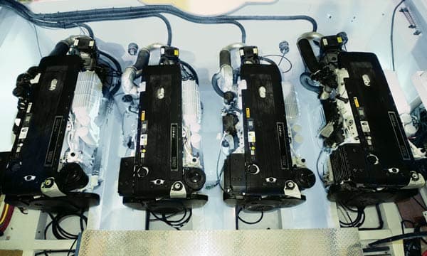

    I can’t imagine having to maintain 4 engines and drives, even 3. Must not be a lot of space to work on anything.

    It was during the POD craze when every builder was building a pod boat, it was all the rage at that time. BUT, at that time, all you could get were the IPS 600's, thus the need to install 4 of them. The other issue with PODS in the bigger boats, is the PODS propellor diameter is limited, so even if 2 PODS had enough HP to run at the speeds the builder wants, the propellors don't have enough diameter and blade surface area to get and keep the boat on plane.....with the bigger pods do come slightly bigger propellors but you still see on larger yachts the need for 3 pods still mainly for that reason.

    My son and I had a closer look at the Lazzara 75 LX Quad IPS. Also the access to the engine room for major maintenance through the tender garage (with removed garage bottom) was very good, daily engine checks and service were a bit more difficult. Standing between the hot engines would not have been my favorite position (very small space between the engines and standing height with the garage floor installed).
    We were facinated by the performance and the maneuverability of the quad IPS setup (the IPS 600 was the only available version at that time) and how quiet the engines were inside the boat and on the upper deck. But what finally turned us off, was the upper steering position. Not really a flybridge. But we did like the quality and the design. And then they went out of business. But son wanted an IPS boat !
