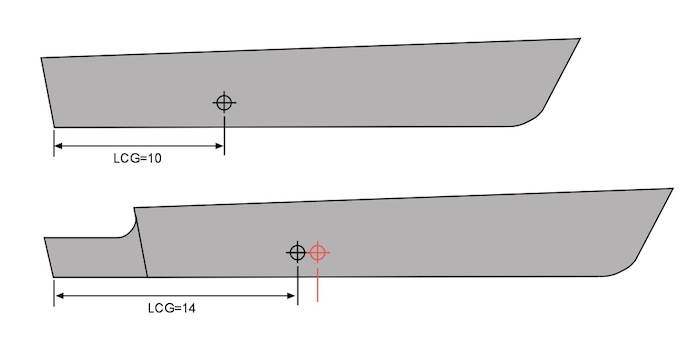

    The LCG is a figure stating the distance from the lowest part of the transom to the CG. The statement was that if you extended the hull aft, you get a longer distance to the CG. Relative to the new hull length, the LCG has moved forward and in some boats they are adding weight in the extension to compensate for this, meaning getting the LCG closer to the same percentage from the transom...

    Which means the CG is aft of the point at which it started. It doesn't matter how far or how little aft the transom was moved or how you want to measure the distance from the new aft perpendicular, the location of the LCG has moved aft of its original location.
    The more weight you add to that extension the further aft that CG moves. It is a fact of physics and mechanics that the CG of any object moves toward added weight. It doesn't matter if it floats, flies, grows, or just sits there.
    The LCG can be measured from the center of the vessel, midway between perpendiculars or from the forward or aft perpendicular. Where it is measured from does not change the physical location of the LCG one femtometer.
    I think you guys are getting confused with the LCB and it's impact on the center of floatation or the point around which the hull rotates to affect trim changes. If you put enough additional buoyancy on the stern you will lift the stern and immerse the bow but that will not change the fact that the weight of the structure that produces that additional buoyancy will move the LCG AFT of its original location.
    Unless the COG is a gearwheel that was not properly secured in the hold and broke loose when the bow trimmed down, that statement is incredibly absurd.

    Of course the CG is aft of the point at which it started, but it can still mean the LCG have moved forward. This is why it may need to be moved further aft...

    You sketch shows what I assume to be what you believe the new LCG (in red) will move to when weight is added aft. You show it moved forward of the initial LCG with the addition of weight aft of the original location. Surely you don't really believe that is possible?
    If the concept is so difficult, take a pencil and suspend it with a thread at its LCGm add weight to one end and let us know what the end with added weight does.
    You are trying to show the new location of the LCF (sometimes thought of as the center of rotation in the longitudinal axis) as being the LCG. A ship does not always rotate about its LCG. This is very apparent in those hulls with sponsons, extensions, or unusual underwater forms.

    I tried to explain it as simple as possible, so try again...
