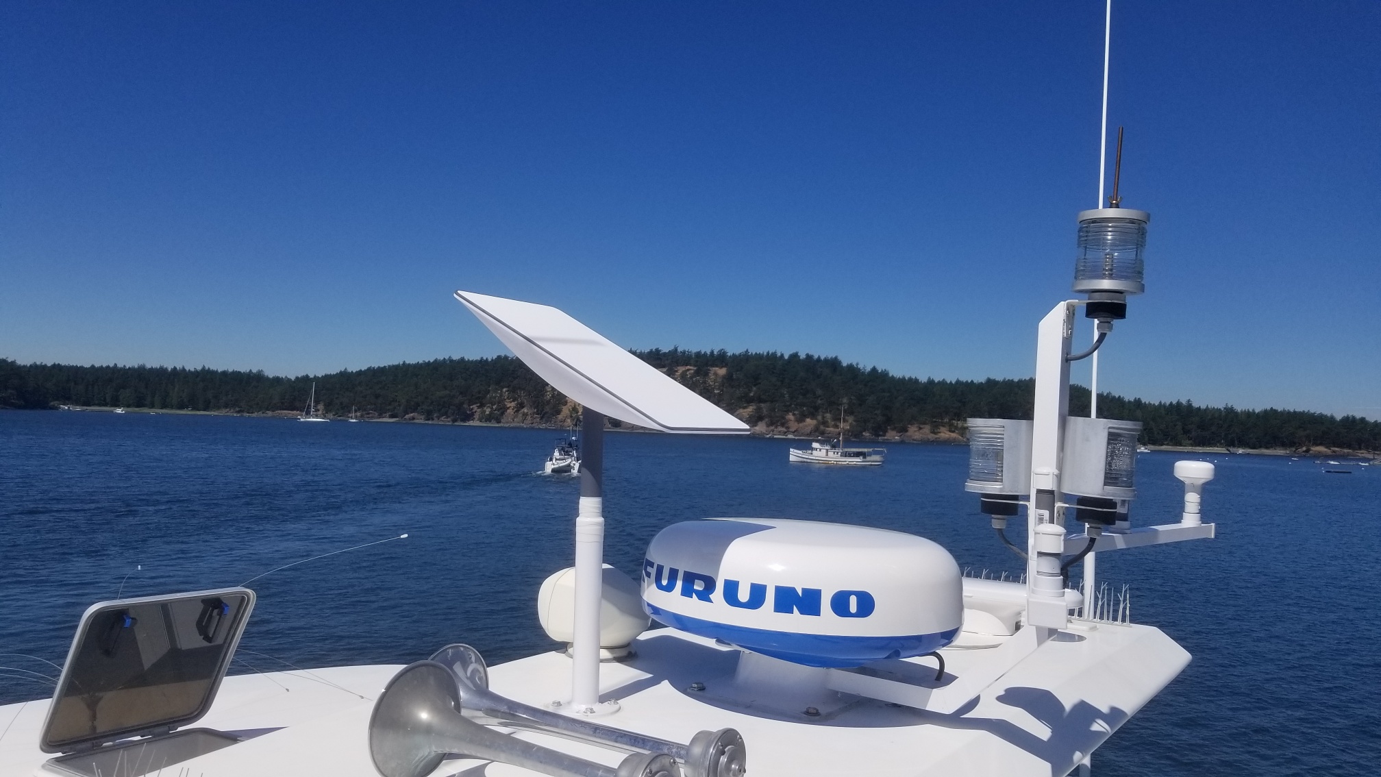

    Received my Starlink package a few days ago. Starting the install soon. I'm going to remove my old back-up Furuno radar array, make a 6" extension and put the antenna there. This will get it above the plane of my Simrad array including the 6 degree max angle. I haven't used the old Furuno since I bought the boat 11 years ago now so I think it's time for it to go anyway.
  18. rtrafford
    rtrafford Senior Member
    Jul 13, 2019
    1,985
    Vero Beach
    I mounted perhaps a foot or 18" above the 12kw open array, and the radar blew me offline. I raised it another 2 feet, and I cleared the radar spray. I was able to use it in every corner of the Bahamas, and no issue in the crossings.
    Be generous with your radar clearance.

  20. TahoeJohn
    TahoeJohn Member
    Aug 8, 2020
    155
    Tahoe VIsta
    My vertical spacing, fwiw. Works just fine with both on. I suppose it matters how close the two are, horizontally.
    Enjoy!!
