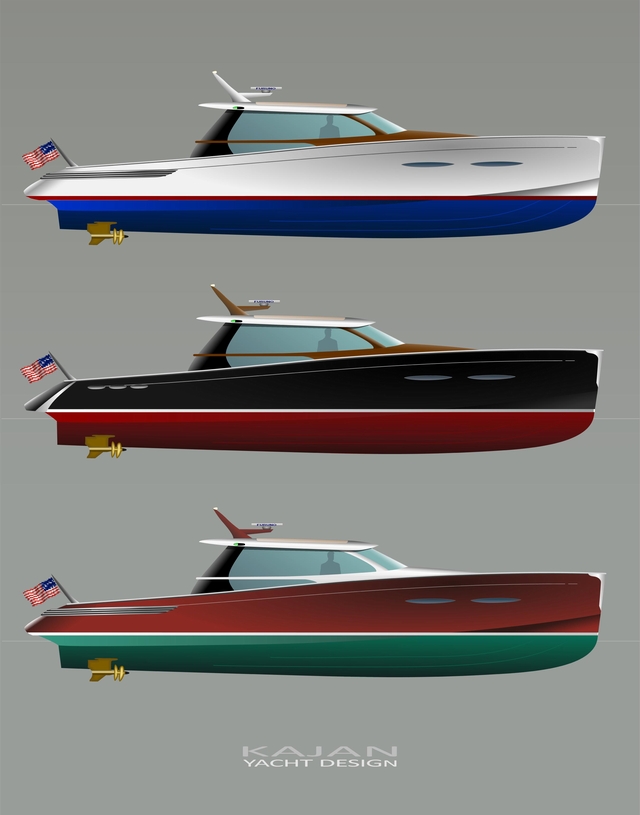

    Sorry for my late reply. Yes, the idea of having all windows, not only the side ones, as power windows did cross my mind.
    The old school design elements might be getting harder to find so I thought I should add some old school paint schemes on the Coupé edition to help some.

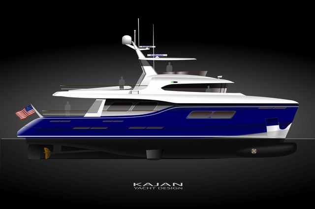

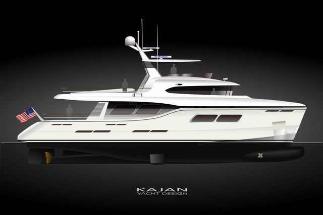

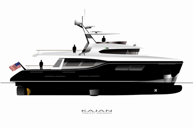

    On this 90ft. explorer I wanted some flavour of “regular” sport yacht with some design elements from my previous 80m Explorer concept.
    A pocket sized explorer with a “modern” touch, and yes, it comes in blue.

    No worry for delay,
    I like personal these a lot but I'm afraid it is getting too far away from the open tender.
    This becomes a beautiful coupe.
  4. ____________
    Really new....looks good.
    Maybe the more straight up back?

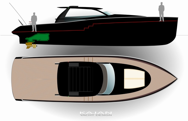

    Kajan, the powderhorn is too overwhelming. Try moving it forward and reducing it a little.
    I also have a question about the one in post #37 and subsequent variations. I notice there is a forward cockpit, but I can't see any obvious scuppers. How much does it affect metacentric height and trim, when full of water?

    Hi Rolf,
    If you by ”Powder horn” are referring to the bulbous bow, you might be right. Don’t forget this is a conceptual design, not a final blueprint, I’m merely suggesting there should be one.
    The fact that I’m in 2D sometimes makes it harder to distinguish certain details due to poor shading such as size for one thing.
    Here I’ve removed some of the shading and perhaps the bulbous bow now appears differently and not so much in need of adjusting.

    The forward cockpit is not enclosed. The slanting and generously wide deck should take care of the spray with some help from gravity.
    Depending on how much high-tech you want, you could of course have hidden “gutters” on the inside and some outlets aft in order not to ruin the clean hull side, should spray become a problem.
    If you take a look at some of the smaller Wally “tenders” you will find a similar forward cockpit with no visible scuppers. Sharp eye though ;)

    What about the idea of a side to side stateroom? Is it enough head room for that? Maybe nicer will be to make the front deck flush.
    Also will give a lot of headroom extra.
    An idea can be to make in the front deck the cushions for sunbed. Maybe with hydraulic head to lift to sit little upright.

    Sorry, I should have been more clear. I was referring to the powderhorn sheer of the design in post #61. Traditionally avoided altogether, but it can be made to look good in modern designs.
    A bulbous bow isn't really an aesthetic feature. It will improve performance in some operating conditions and degrade performance in others. I don't think many yachts, except perhaps large long-range yachts, will benefit.
    I'll also add, from personal experience, that stabilising fins are a PITA to operate and maintain. I've had fins stick in an extended position, and you'd better make them easily accessible in a comfortable working position for the poor engineer who has to fix them.
