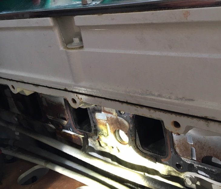

    Boat is running well now. Both engines turning up just below 2350 rpm at 98-99% load with nearly full fuel, full water, all our stuff and a lot of tools. It was an eye opener to see the size wrenches the tech used. What was done:
    1. Charge air cooler to intake gasket replaced
    2. CAC matrix cleaned
    3. Valves adjusted
    4. Valve cover gaskets replaced (2 per engine)
    5. Port exhaust gasket replaced and turbo cleaned
    6. Starboard starter replaced
    7. CAC bolts replaced with longer bolts and an extension sleeve to increase clamping pressure on the CAC gaskets between the cover and the basket.
    The really careful cleaning of all gasket mating surfaces was something else I did not expect. He practically polished the intake gasket surfaces before applying silicone to the metal gaskets replacing the old paper ones.
    Picture of the bad intake gasket on the port engine.
