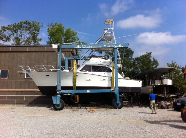

    My nj post
    [​IMG]
    [​IMG]
    [​IMG]

    IR, you are doing a great job, perservere as us men do. It will be worth it. Brock 71 when looking at early Post Yachts that are still around from the seventies they may need work; but those old girls made it through many years. If you look around you may not find some of the competitor boats of the same vintage still floating. Good Luck to both of you, My 46 Post is 99.9% done. NOT- I am sure any new gadget that becomes popular will find its way to my boat.:)
