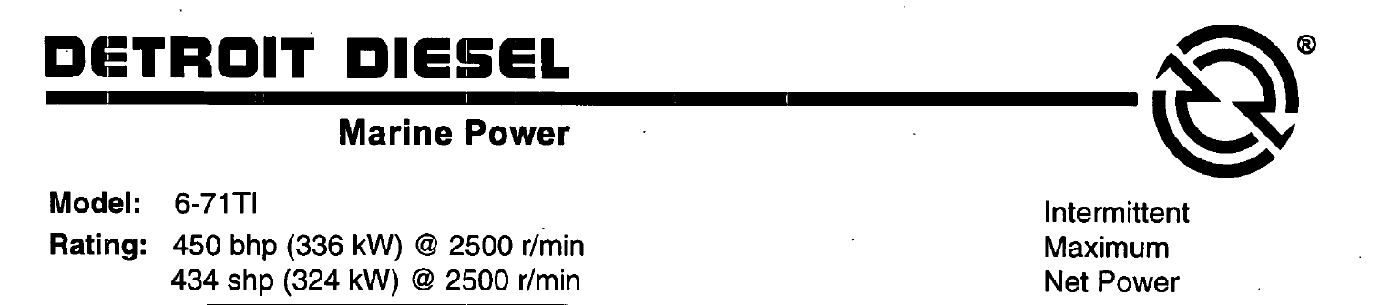

  2. PacBlue
    PacBlue Senior Member
    Jan 9, 2009
    2,002
    Dana Point, Ca
    410 0r 450hp?
  3. MBevins
    MBevins Senior Member
    May 23, 2008
    1,263
    Windsor On. Canada
    450's

  5. Pascal
    8,938
    450hp 671s? You really don’t want to have these overpropped I’d avoid running over 1800 until this is resolved

    @ 450hp, Then 6-71TIBs.
  8. PacBlue
    Jan 9, 2009
    2,002
    Dana Point, Ca
    For the pictorial leaning learners:
    The 'B goes without saying......
  9. Capt Ralph
    14,545
    Yes, I have the big sheets.
    But HP went without saying for a while also.

  11. Capt J
    14,889
    I know you want to wait, or your yard does until winter haulout, but honestly me personally, I'd want to test the re-pitched wheels before next season and not wait until next season and realize that they're still off and have to deal with it at the beginning of the season and lose time.
  12. MBevins
    May 23, 2008
    1,263
    Windsor On. Canada
    Yes I would too but there's no Time.
    I have to be in another part of the world on the 20th, There's no way for me to stop somewhere and get this done AND get the boat to it's storage facility. So in the spring I will fly in to the storage facility, launch , do some test runs and fly back home. Unfortunately it is what it is. If the yard dealing with this decided to screw me it's on them, I'm not losing sleep over it.
