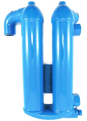

    You have fluid coolers. On a gas Crusader, located in that big, ridged, U shape thing, front-right of your engine.

    Sure enough I beleave it is coolant. Found some under the fluid cooler. I'm gonna guess the anoids. Says to replace every 30 days I never have. The fluid I think was coming from UNDER the boat where the fresh water comes in. Thanks for the tip. Another project.
