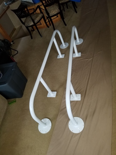

    One of my better projects was having built this tubular RIB stand.
    The contact areas are covered with white PVC hose (no scratches and no slipping).
    It will accommodate many different hull shapes.
    It holds my buddies 10’ AB RIB. Can probably go 14’ if needed.
    The square pads bolted to athwartship alloy frames already installed on the boat.

    Like the custom job! I definitely like the flexibility and load-spreading of linear chocks. I wonder why more people don’t use them? Millions of boat lifts and trailers can’t be wrong.
    Strong agree that dedicated tie down eyes are mandatory in any case. Was thinking that tight, stout tie downs would minimize uneven loading in the stand chocks (and eliminate the worst case scenario of bouncing and shifting).
