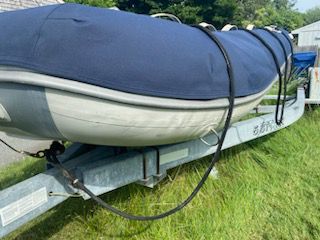

    I had a few inflatables over the years, always hypalons.
    Painting the tubes was never a good idea but applying Sun covers (chaps) over the tubes has added years.
    Sunbrella chaps seems popular among the liveaboards.
