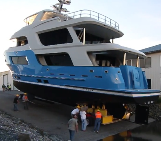

    I dunno
    Desktop did.

    The transom engine room door does appear to be open.
    It looks like they may have hit bottom around the same time that the stern achieved buoyancy. It seems inescapable that water was entering the open transom door, which negated the buoyancy and the yacht reached the bottom. It is possible that the door was closed at some point during these events, or the natural roll of the boat brought the water line away from the door opening. I am struggling to explain how the yacht regained buoyancy and floated further out into the basin.
