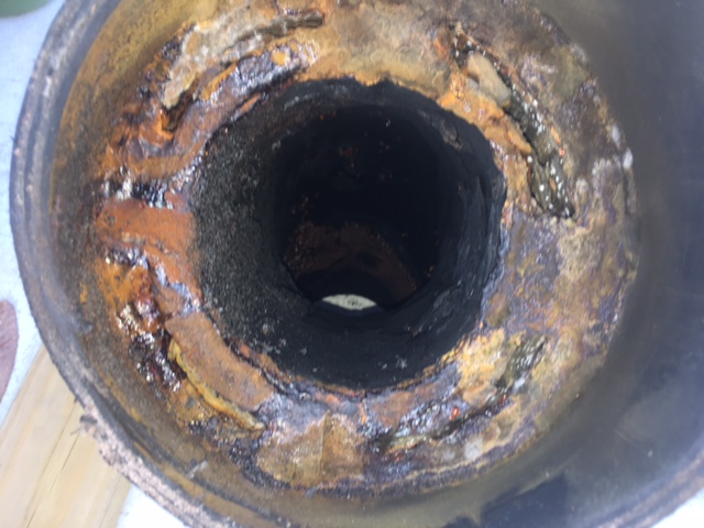

  3. baltimore bob
    baltimore bob Member
    Sep 22, 2013
    314
    Baltimore, Maryland
    Gee, nothing wrong with the starboard elbow....:p
