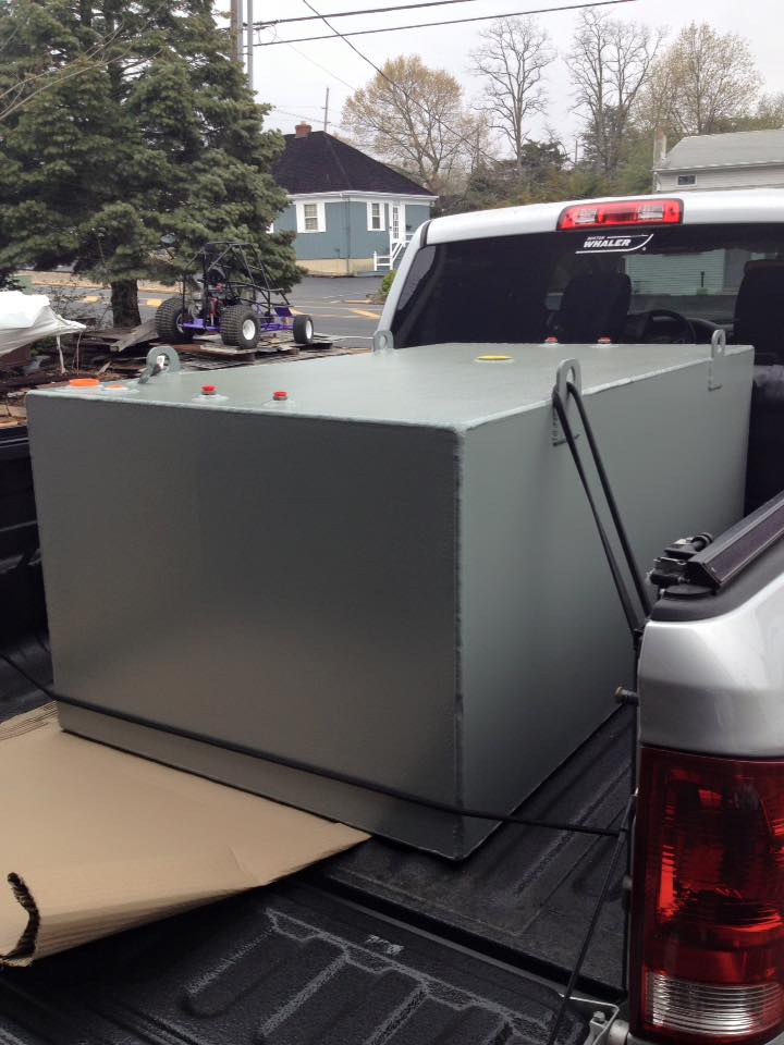

    Off to New Jersey early tomorrow to pick up my new aft tank. Atlantic Welding has been a joy to deal with thus far, looking forward to seeing the finished product.
  8. baltimore bob
    baltimore bob Member
    Sep 22, 2013
    314
    Baltimore, Maryland
    new tank 1.jpg Got the tank....looks great. Very pleasant people. Atlantic Coastal Welding gets 2 thumbs up!
  9. shawn
    shawn New Member
    Feb 13, 2006
    126
    old saybrook ct
    Looks like it was coated with something?
  10. baltimore bob
    Sep 22, 2013
    314
    Baltimore, Maryland
    Yup. Epoxy coating is standard.

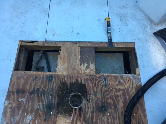

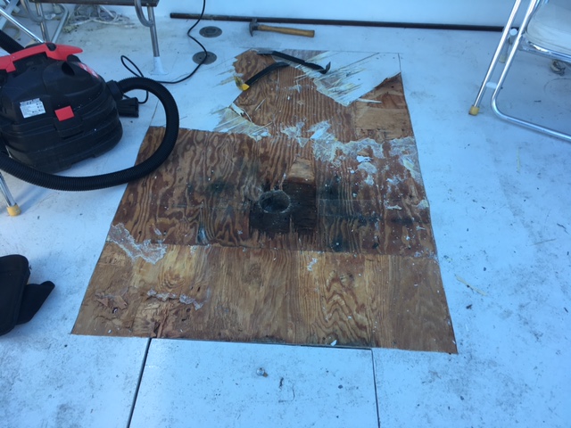

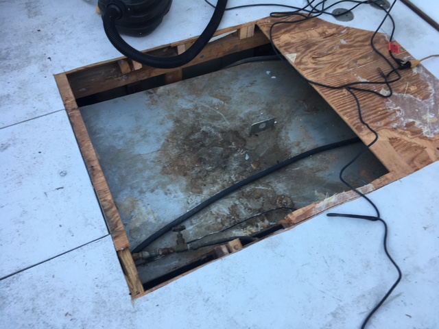

    Well I've been tap dancing around this all summer....time to get started.
    [/ATTACH] tank2.JPG tank3.JPG tank4.JPG
  16. shawn
    shawn New Member
    Feb 13, 2006
    126
    old saybrook ct
    I thought you had done the aft tank
  17. Capt J
    14,887
    If not, I'd recommend cutting more of the deck and changing the aft tank now. It would really suck to redo the deck and a year later have to tear it all up the change the tank.
  18. baltimore bob
    Sep 22, 2013
    314
    Baltimore, Maryland
    I've been putting off replacing the aft tank all summer, I had it built last spring....yes there is another foot to cut out.
  19. C team
    C team Senior Member
    Nov 1, 2011
    257
    Kent Island
    I can't believe Post would put a shutoff valve on top of that tank as shown in your picture. How would you ever get to it?
  20. Capt J
    14,887
    LOLOLOL, I once had to cut a 6" hole in the center of the cockpit floor of a 32' Luhrs and then put a pie plate so I could change the fuel tank sender.......You'd be amazed at the stupid stuff builders do.
