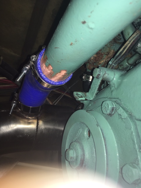

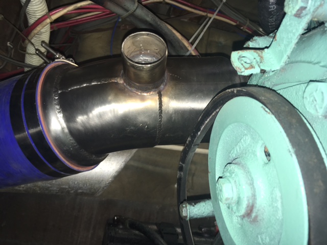

    Port elbow on. Fits nice EXCEPT to get the exhaust host to line up it had to be rotated until the water input is now right in front of the alternator drive pulley. Why oh why couldn't they have just put a straight nipple on it?

    If the inlet would have been on top it would have been MUCH better!

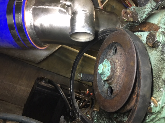

    The water will drain OK, it's the water inlet which is the problem. As this was supposed to be an exact equivalent to the old one I'm a little unhappy. Same J&T part number. Some 2 inch copper pipe and a couple silicone elbows will remedy it, just a pain. This picture shows the problem a little better. Yeah, I know, engine needs cleaned and painted and the nasty (I don't call it crappy anymore;)) wiring needs to come out.

    71s rule! Actually I was talking about the wiring mostly. I went to the boat today and checked to see what would happen if I swapped sides. It would be more of a problem and I'd have to add a J turn to the water line and adding more restriction that I don't want and the plumping would still have a significant low spot. What I really should have done was check out the installation as soon as I received the elbows last fall. So yes, there will be water not draining from about 2 feet of 2 inch line. I have e mailed J&T about this, suggesting they spec this part with a straight connection, the customer can add a 90 if needed.

    I have 6 71 naturals, so no turbo and a different cooling arrangement than you. I have a front mounted belt driven raw water pump (why they did that I'll never know) with heated raw water exiting the exchanger on the inboard side. It then converts to a 2 inch copper tube, runs back above the blower and turns outboard at the rear of the engine. With the original cast iron elbow that last run was a straight shot and everything drained.

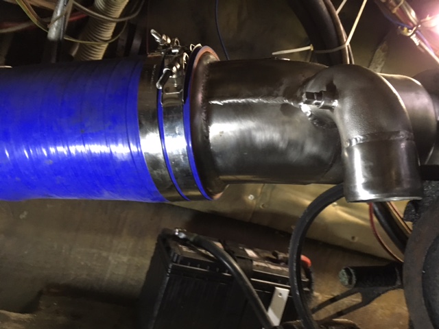

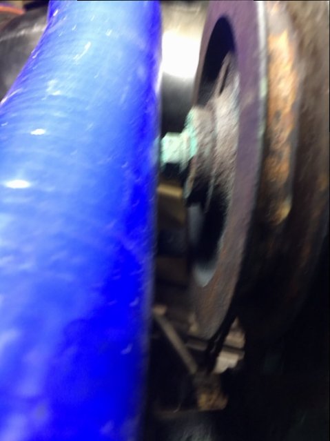

    This isn't going to cut it. Elbow is coming back off and sent to weld shop. J&T is back on my $&#@ list.

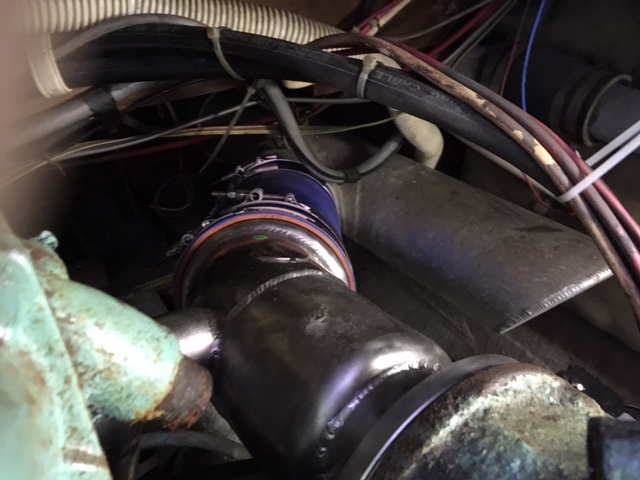

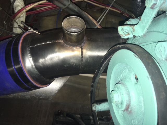

    A hundred bucks spent at the weld shop (did both) and the problem is solved.

    Ahhhh, much better. Original feed pipe fits as it should!
