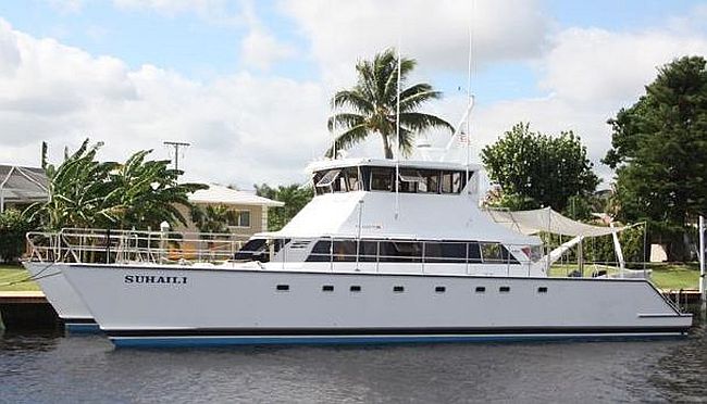

    62' Powercat for Sale
    Well that good friend of mine has decided he is going to sell his vessel as his treasure hunting days are limited.
    Here is the listing along with photos I didn't have.
    1999 Catamaran Malcolm Tenant Cat Craft Custom Pilothouse Power Boat For Sale
    $750K...a good deal by todays std's to build a new one
