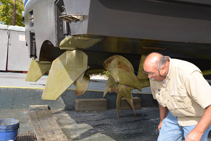

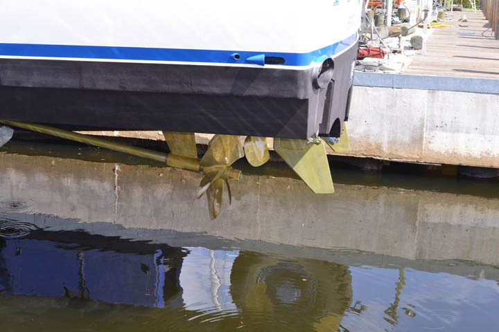

    View attachment 73412 I don't know why I'm overthinking the prop speed this year as I've used it 10 times. I guess it was the yard wanting to change to prop one. I'm estimating the yard does 10 boats a week with prop speed. I stopped by yesterday and talked to owners and looked at a couple of boats with prop one. By all accounts, it looks, acts, lasts and costs the same as prop speed. The yard just felt like they were having too many quality issues with prop speed and the company wasn't standing behind the product. They're the ones doing the work and they do stand behind their work so I have to respect what they say. I heard the same story from another yard that does a lot of Vikings.
    I did an underwater inspection of my boat yesterday at 15 months on the bottom job. The picture below is from a haul out at 4 months by a surveyor. At any rate, at 15 months all the prop speed is gone from my props and rudders. trim tabs and shafts are still completely covered and cleaned with a cloth. The micron has held up extremely well. No wear at the water line and the bottom is perfect. Highly unusual for me to get that much life out of it but I'm in a pretty still canal. The props have been scanned and the boats just runs out perfect so I'm going to keep doing what I've been doing. I'll just wait a couple of more months. I'll try the Prop One and another coat of Micron after proper prep.

    If you've had such good results with prop speed, keep it. Why change to the unknown? I'd just tell the yard you want to stay with prop speed. I think 14 months is about all you're going to get on props and rudders if you're using the boat a bit and pretty darn good actually.
