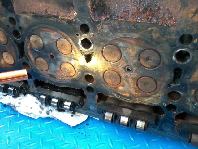

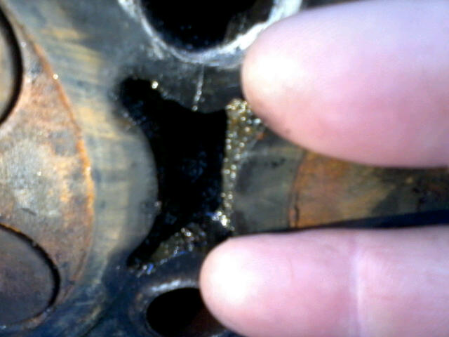

  5. ntavila
    ntavila New Member
    Dec 28, 2011
    14
    FLL
    Here's the pic of a beat up head. Since it took me a couple weeks to find a mechanic, it rusted over pretty good. It's amazing how quickly rust sets in. Also a pic of a visual crack in the valve.

  8. Capt Ralph
    14,340
    Is that salt (white ring) or water corrosion around the water passage?
