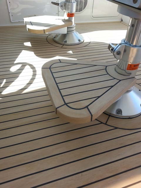

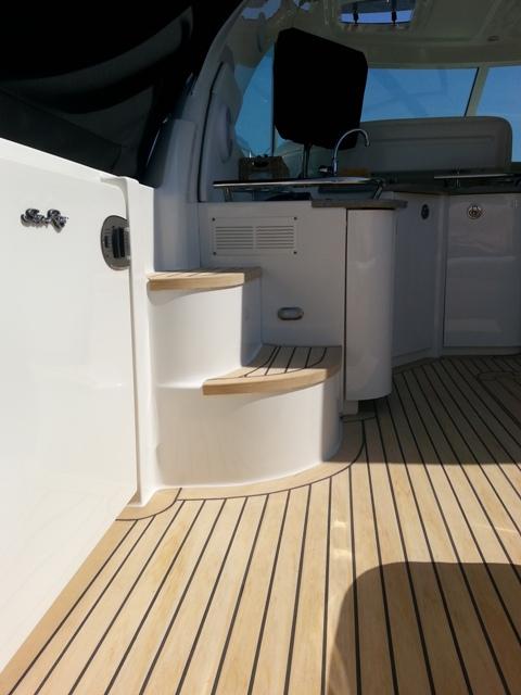

    Good day All, Reviving this old thread on FlexiTeak Vs Real teak. I've had flexi Teak on my older Searay and it held up extremely well, it was 2G scrubbed style with some nice bordering and install was a 10. See pix below. Anyone that walked on the boat thought it was real teak. We sold that boat and now have a Sunseeker 57 Pred, 2018. It has the typical 1/4 Teak deck that is inset and flush with the platform. I am the second owner and the previous owner killed the teak. So I have to replace it. I see that sunseeker is now using flexiteek on the new builds. So my question is how do you think this will fair on the resale if I decide to install flexiteek? Wondering if the thought process has changed since 5 years ago.
    Also, up in the north east USA, Long Island, there are no local companies that I have found that can install real teak. Does anyone have a resource should i decide to go that way?
    Lastly, talk to me about teak. From the research i have done you want Burmese teak only and NOT farmed teak.... or is that all BS?
  18. Capt J
    14,887
    I think real teak looks classier and such. One of the yachts I manage happens to be a 2022 Sunseeker with the flexi teak and it looks like it clear isn't teak from 10' away. BUT there is no maintenance to it, so there's that as well as the lower install price.
