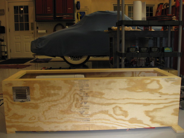

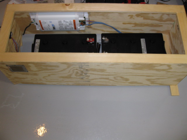

    I am moving out of the study and explore phase and into the installation phase.
    Since my boat is in Oak Island, NC and I am in Newtown, PA, I have resorted to building a full size battery box to replicate the fiberglass seat box where the batteries will be installed once I get to NC. I got this idea of modeling from studying how the USS North Carolina WW II Battleship was constructed. Before any actual construction could proceed, a full size mockup of the actual room was constructed in a warehouse in the Brooklyn Navy Yard (http://www.battleshipnc.com/history/...?resultpage=5&). Once approved, the actual construction would begin. They were able to know that everything would fit and because of this, many parts could be ordered/constructed in advance. They moved from the beginning of the project to sea trials in an amazing 3 short years. That was very fast for a very complex battleship and just one of the reasons we won the war.
    Since CAD programming is cost prohibitive on my budget, I decided to follow the same full size mockup process. I constucted a plywood replica box to the actual seat box that the batteries will be installed. I will be mounting the ProNautic battery charger (you can see already mounted on the back wall of the box), ANL fuses holders, battery On/Off switch, Yandina battery vent-fan-control and Amp gauge shunt on the back wall. I was able to draw these in to scale on the back wall so that I could measure actual battery cable and battery charger cable lengths in advance to traveling to NC.
    I called this order in on Friday afternoon and expect to have cables by this Thursday. I can't wait to get my shipment and start the actual install.
    I have attached two photos of the box. You can see the vent cover on the front that provides protection for the muffin fan that will supply fresh cool air during the charging of the Deka 8D AGMs.
    I will supply more photos once I start getting the parts to fill up the battery box. :)

    Suggest you put the isolation switch outside of the battery box to make it accessible in case of a casualty. If the batteries were catastrophically failing or the load was not responding to normal commands (windlass; bow thruster, etc.) the ability to shut off power quickly without removing cushions and panels would be very much appreciated after the fact.
    Charlie
