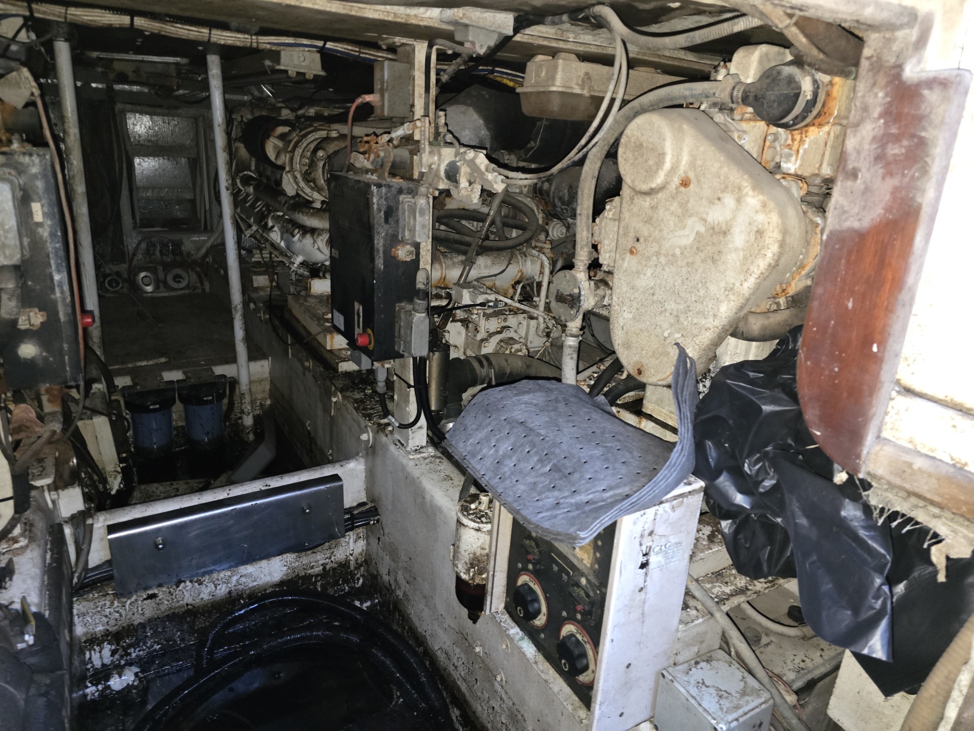

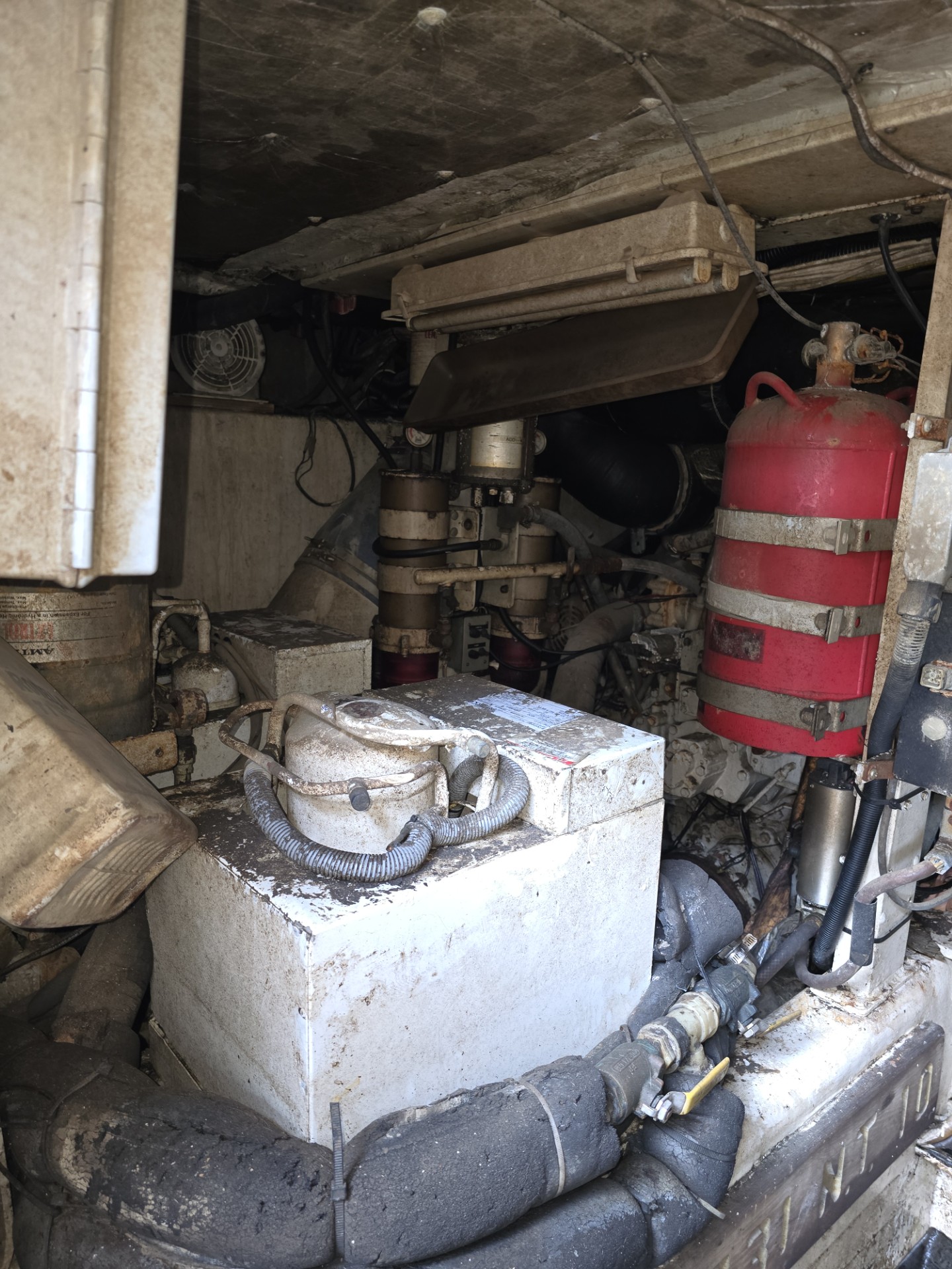

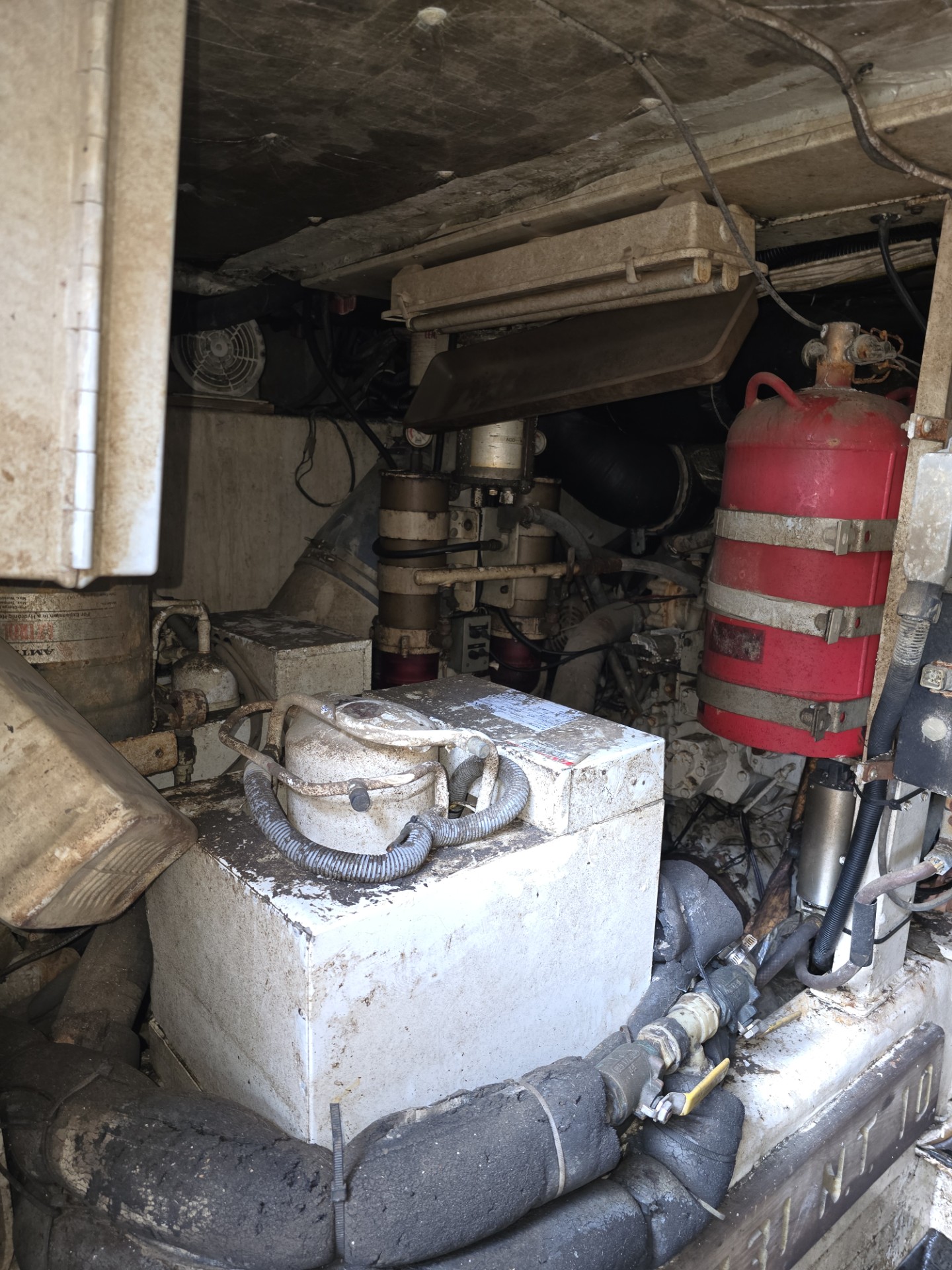

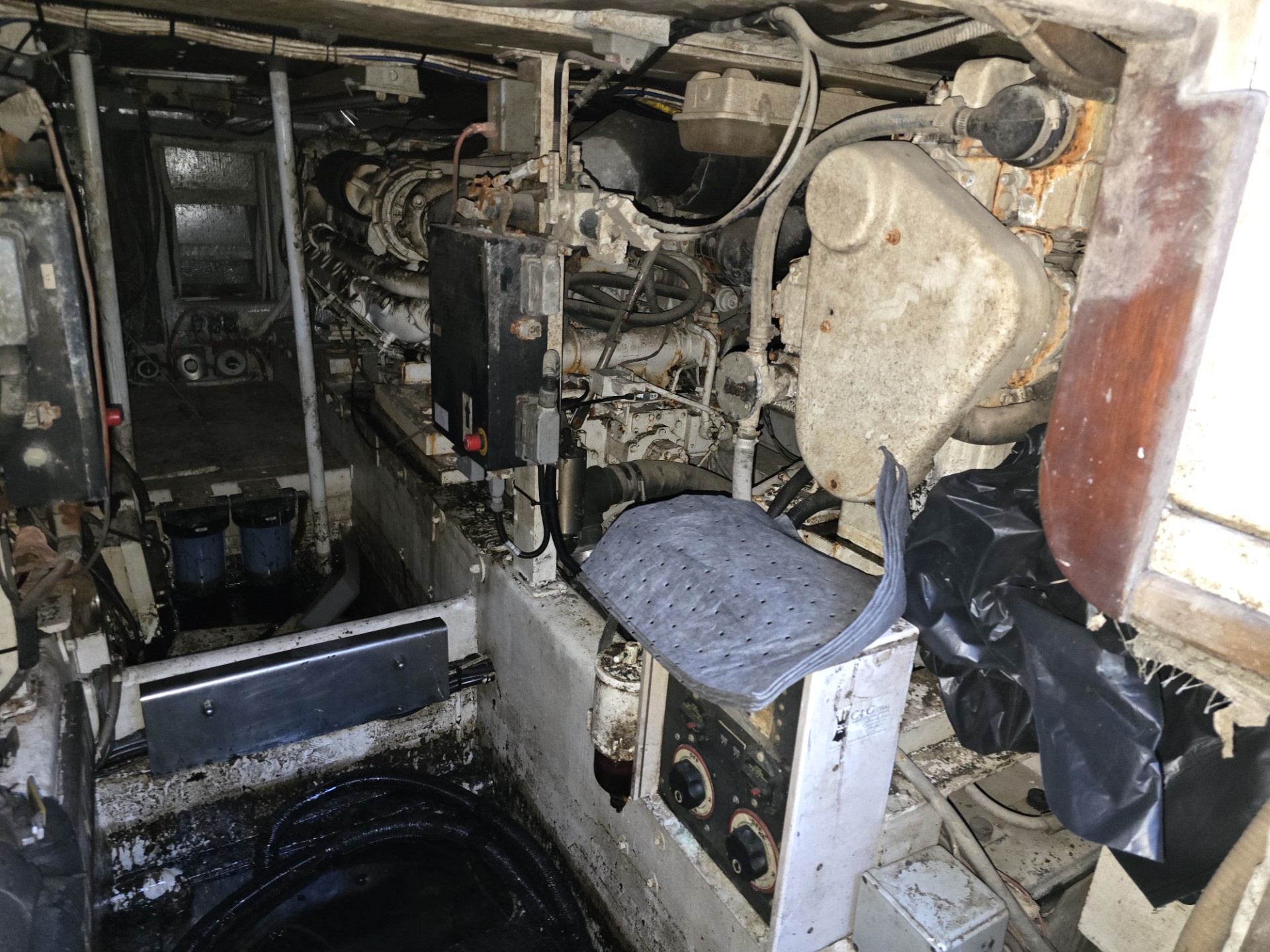

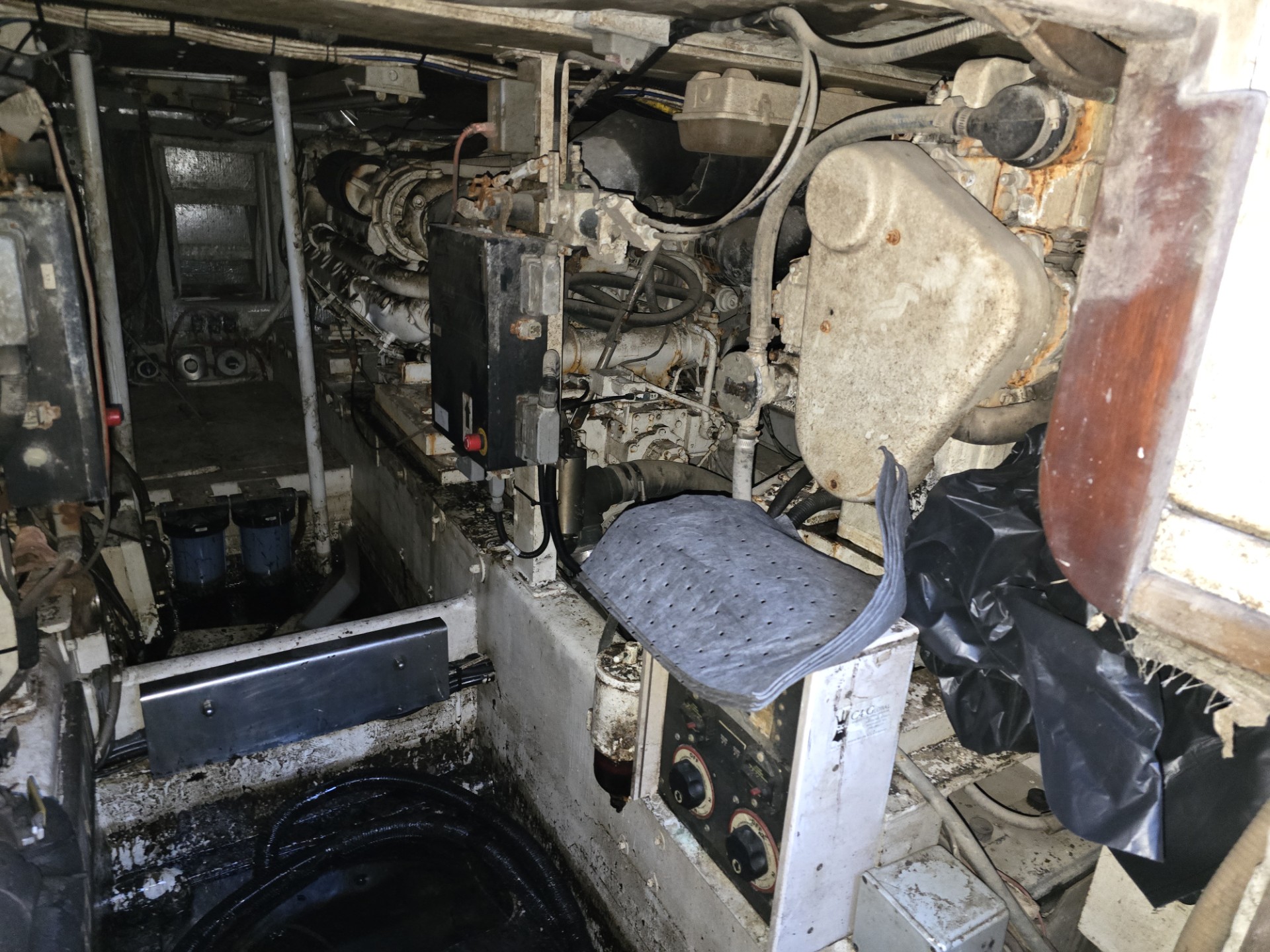

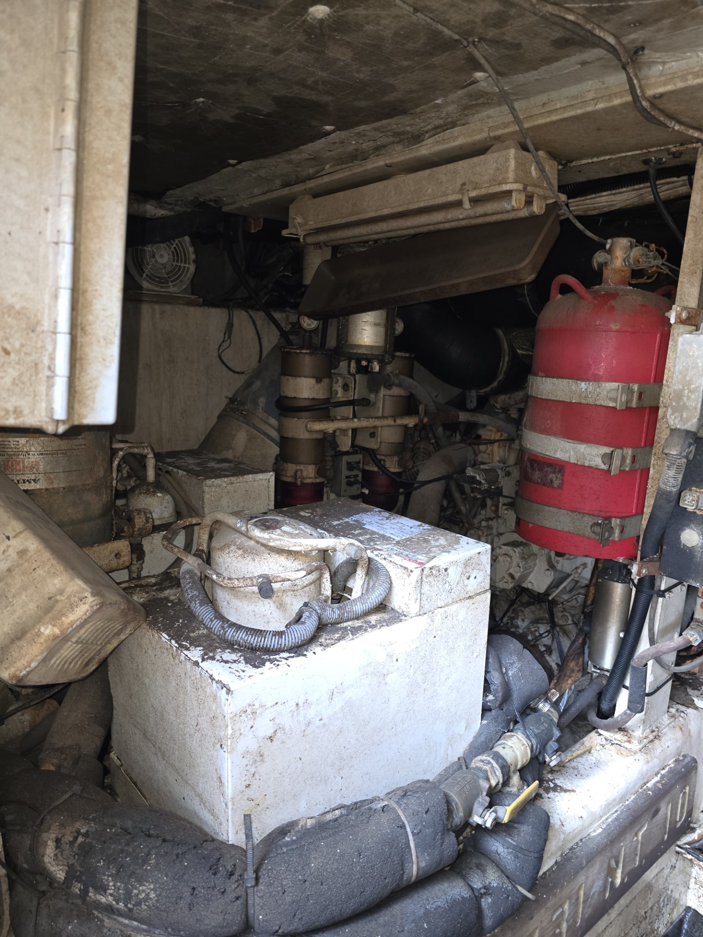

    Hello Dockmaster, I have been working on a 1990 54 Donzi, looking at your repower of your vessel . It looks very clean on the installation and routing was tidied up very amazing job. I'm in the process of rebuilding my engines and looking at different things to try to organize the machinery space to flow better for maintenance and access and clean it up. was wondering if you have some more photos and locations of major components as I am wanting to move pumps, A/C chillers and batteries etc. to a more organized layout with the limited space. also, the cross beam under the engine oil pan between the stringers, did you cut that down to accommodate removal of the oil pans in the future? mine will not allow me to drop the oil pan fully.

    What engines do you have? Do you not have two piece oil pans that allow removal? My a/c chillers were never in the engine room. They are in the fwd machinery space located between the staterooms. My starting batteries are in the center of the engine room between the engines. My house batteries are under the stairs into the engine room from the cockpit. I have three more batteries after of the starting batts between the engines.

    Thanks for the reply, the boat was Repowered in 2001 with MAN D2842LE404 at 1300Hp per side. I purchased the boat in 2024, The oil pans are one piece and i have yet to find a 2 piece variant to replace. both A/C chillers are located behind the port engine, with battery chargers on the rear wall. I have 4 8D batteries between the engines. the House batteries are located underneath the generator behind the starboard engine, the generator is mounted between the engine stringers. i was looking at relocating batteries under the steps going into the engine room. i have not been in the forward machinery space to see how much room is underneath. from the two hatches in the floor i see water tanks. The rear Fuel tank takes up all the room in the Aft so relocating things there is not an option. See the photos, it is embarrassing however it is a project and in process. Port AC.jpg Starboard Generator.jpg

    Yes, it is. Brave, haha. More mistake then anything else. However taking small bites, now I'm at the point i need to start on the locations of electrical and hardware so looking at options to plan it out. I have the port engine with new pistons, rod bearings, liners and heads machined.
