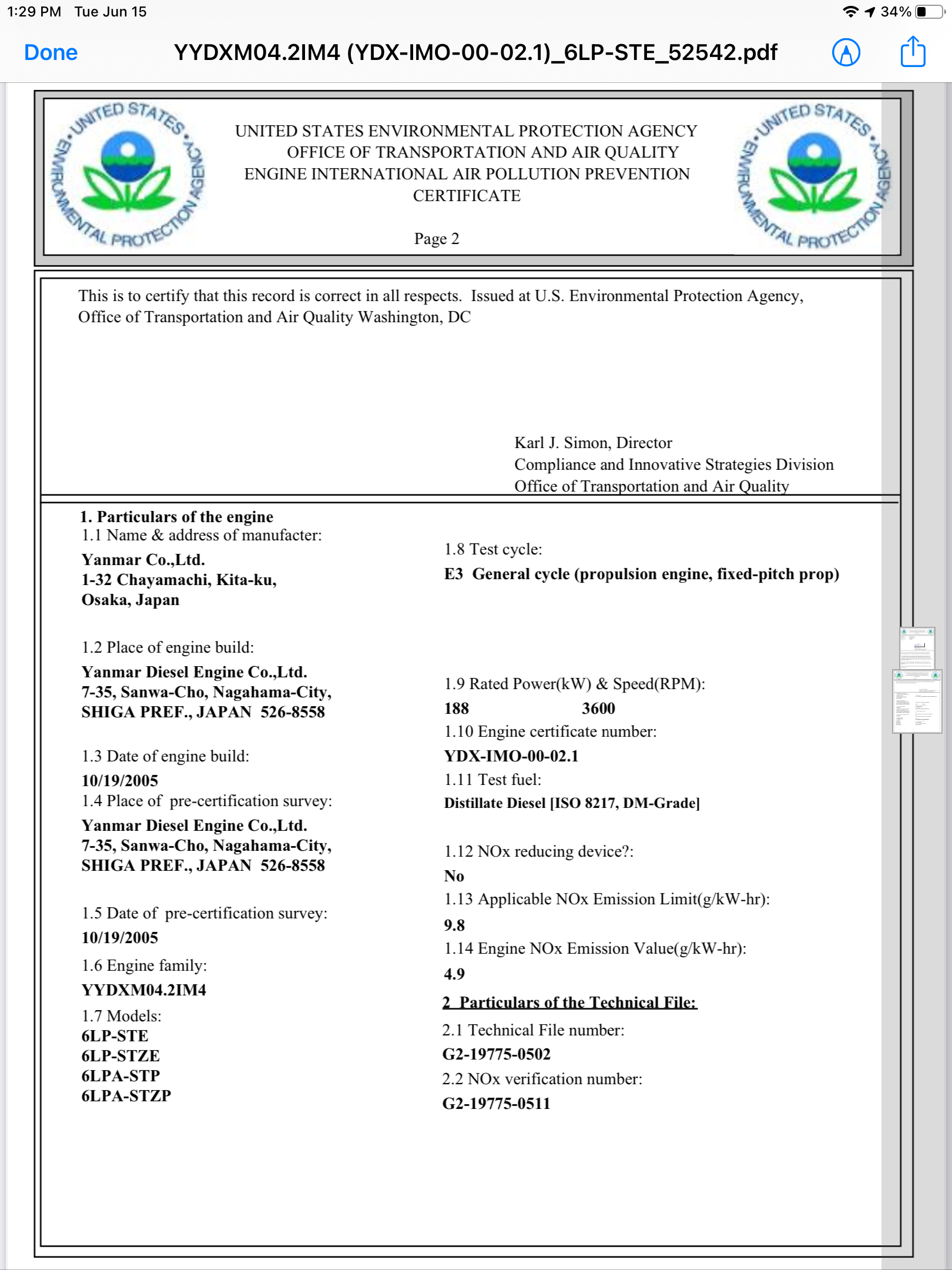

    Maybe there is a God:
    Got this certificate from Yanmar today,
  13. olderboater
    olderboater Senior Member
    Sep 2, 2013
    7,127
    And was it free?

    Palm Coast, Florida
    Yes, free…:cool:
