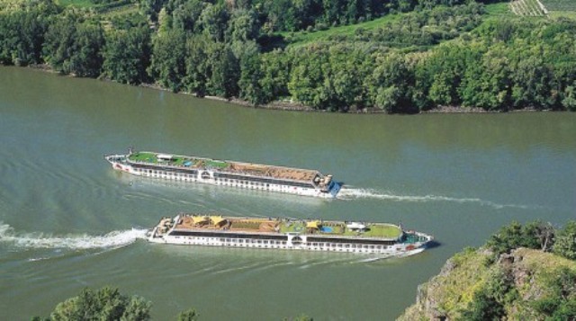

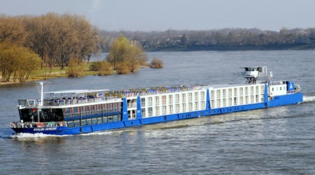

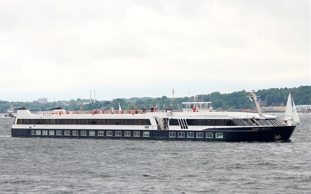

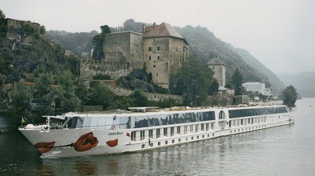

    Marmot has found these inland cruise vessels interesting. As I said, that is big business in Europe, also most of their passengers are in the 70+ age. It is a very easy and convenient type of traveling. Those ships stop at most points of interest and the passengers are carried by busses to the hot spots in the area. These vessels provide great comfort, excellent food and entertainment and the service is remarkable.
    Those vessels come in different sizes from 85 Meters LOA (88 passengers, 20+ crew) to 135 meters LOA (200+ passengers and 45+ crew). Below some examples of those ships.
    And if you have to live with limited draft and airdraft on those rivers and you need 3 decks to get the amount of people on board plus all the ammenities you need, somebody has to live below the waterline with partially flooded windows. Very interesting on those ships are the retracting wheelhouses, that totally disappear below deck level and make the skipper navigate only with a bow camera.
    Very interesting, both from the technical aspect and from the financial espect are the detachable inland passenger vessels (pic1), where the complete command and power section and most of the crew quarters are located in the rear of the vessel and connected by couplings to the passenger part. The rear part can be disconnected and replaced (for maintenance or repair) and the forward part continues the journey with a spare unit or can be used as floating hotel with shore power. A very flexible and profitable but not very pretty design. Like space ship Enterprise with her detachable disk and her combat module :D.
    BTW, many of those inland crise ships are built by the Neptun yard, a member of the Meyer Werft company.
    The last pic shows a smaller inland cruiser, an 85 meter by 9,5 meter cruise ship for 88 passengers (Europe class). I was recently shown a design and plans (based on this vessel) for an inland waterway megayacht. Owner suite, 5 VIP cabins, salons, dining, entertainment and wellness like on a large megayacht, two tender and two road tender (cars) for exploring the hotspots near the rivers and canals. 10 to 12 crew and great luxury. That was an interesting concept, a sleek and modest external design. I am looking forward to see it come into reality.
