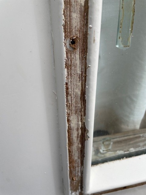

    I have removed my wooden window frames on the outside by using a heat gun on low setting to remove paint and expose bungs. Careful not to heat the glass or other surroundings. Then I drilled a small hole in the middle of the bung and screwed in a wood type screw to push bung out. I removed all the screws and pryed frame carefully away. The window glass can then be removed and replaced. I would next time, paint the frames first before reinstalling and just touch up the new bungs. That would have been easier for me.

    No a GB. I did not see that he was asking for a Post. I figured 1980 42, he was talking GB, not realizing I was in a Post sub thread.
