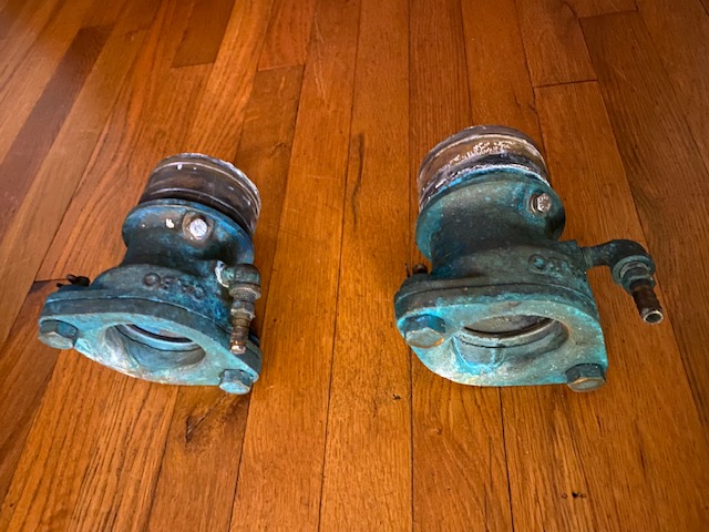

    I just completed a 1,000 + nautical mile trip bringing to 40’ Cabo back home to Virginia Beach. The only issue I had was with the stbd OEM shaft seal. It overheated due to lack of cooling water flow. Do you have any drawings and or info on these types of seals? I’m trying to determine what if any service I can complete while the boat is in the water. I’m also putting together my plan when I haul the boat out of the water which will include installation of the PSS seals.

    I just removed my original Cabo lip seals and will be installing the PSS Pro series shaft seals. Cabo Lip Seals .jpg

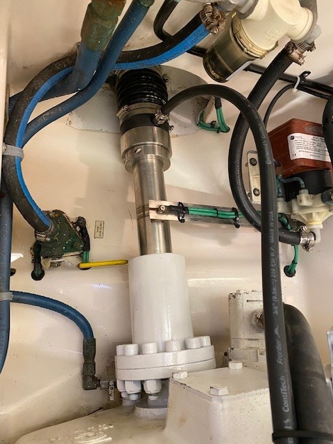

    PSS pro's installed and are performing perfectly. Very happy with this upgrade.

    Looks great. Nice job on the coupler paint work as well after install.

    Might bead blast the Cabo seals and they can be a nice paper weight on my desk. I really like the clamping collar on the PSS Pro seals - a good simple design that backs up the set screws in the rotating collar.
