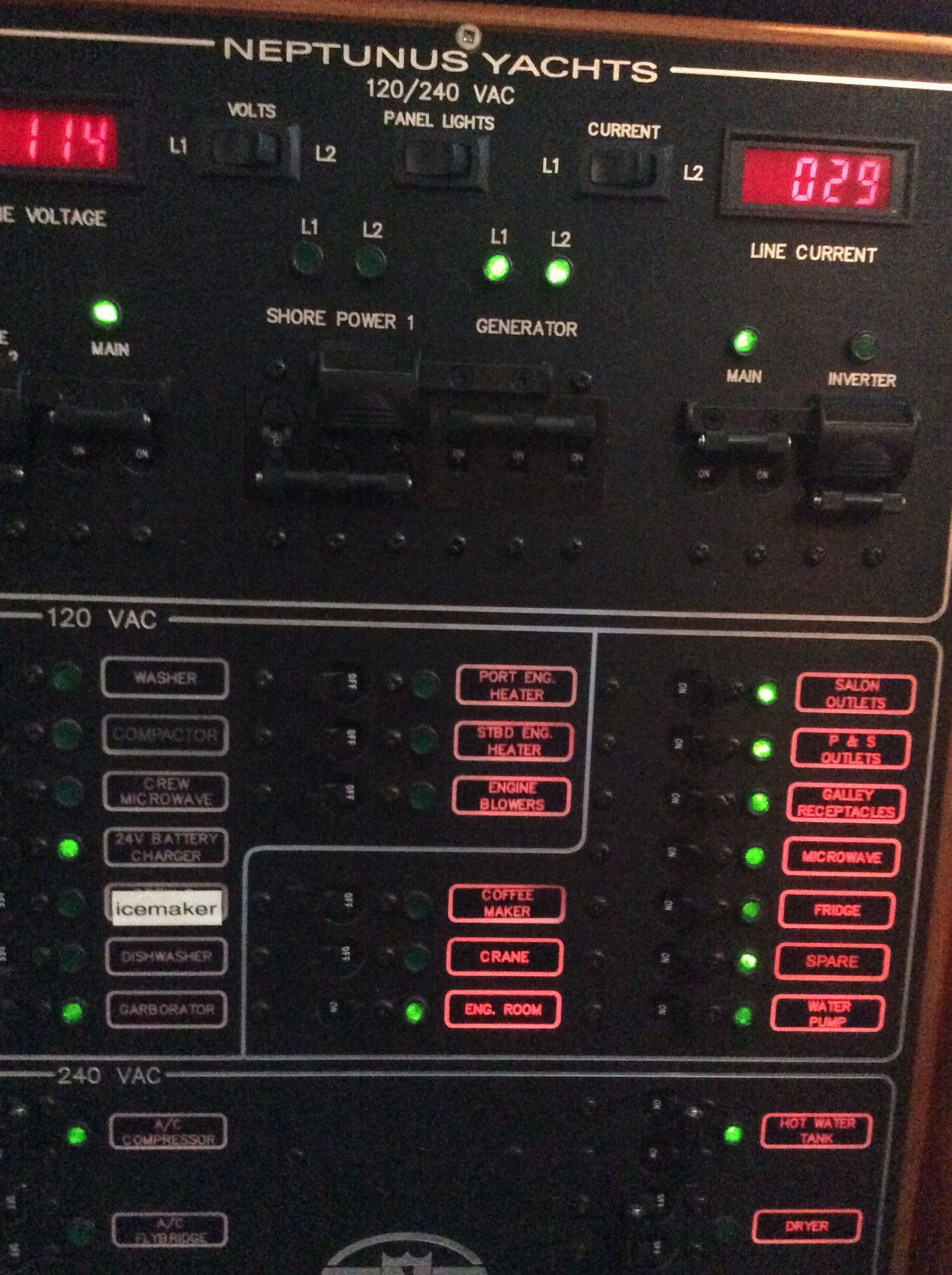

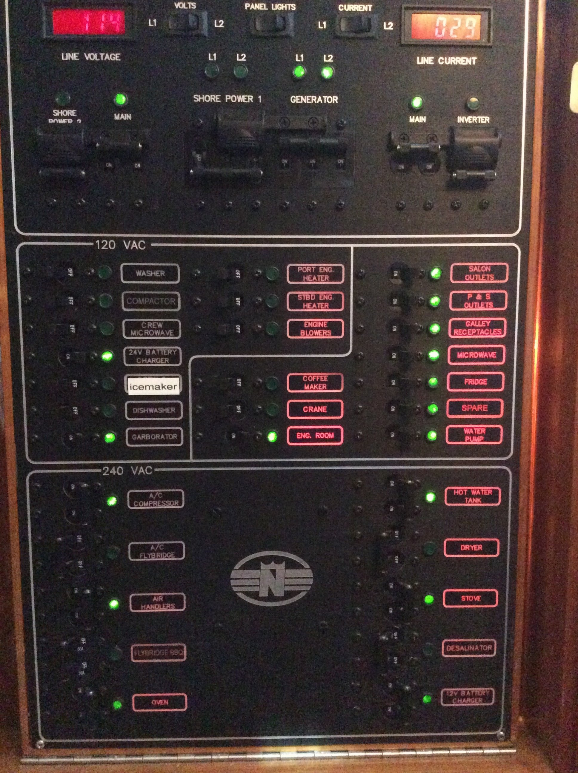

    Every Neptunus I've run 55' and 62', you were able to run off of one cord. Please take a picture of your electrical panel where the breakers are to select shorecord 1, shorecord 2, generator etc.

  18. Worthy vessel
    Worthy vessel Member
    Feb 16, 2019
    83
    Sarasota
    This is with the gen running
  19. Worthy vessel
    Feb 16, 2019
    83
    Sarasota
