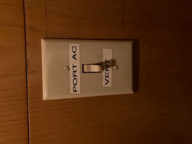

    So we had some time on our hands so I asked my guy to troubleshoot why the port side air handler in the master stateroom wasn't working when I was using the A/C last time. So he pokes around a bit and in the process of getting ready to pull the access cover in the hanging locker to get to the air handler he finds a switch in the back of the locker. It looks like a typical light switch except it's labeled Port AC on the on side and Vent on the off side. He flips to on or Port AC , and walla - the air handler kicks on. So my stupid question of the day is. why would this switch exist? It doesn't appear to be original. I have no idea what it means by Vent or if that's just the way it's labeled. Anyone offer a clue or suggestion here?

    That's not part of our system. Have you verified that the air handler is tied into the chiller loop. It may have been bypassed because of a leak.

    I suspect that the switch is just on/off, and whoever fitted it didn't think that it would have been more logical to attach the label "Port AC vent" on the "on" side, rather than splitting it.
    Ref. the reason, I can't read the mind of Mr.retrofitter of course, but in my boat all cabins have a switch near the beds that allows to switch off the air handler vents regardless of whether they should be on or off depending on the thermostat controlling them.
    That's an OEM arrangement, arguably unnecessary, but I always guessed that the idea was to allow anyone to turn off the air handler without jumping out of bed to change the thermostat setting.
