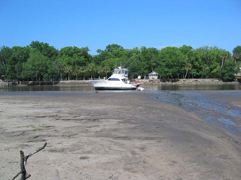

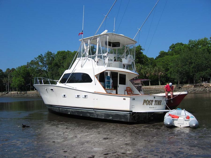

    Ok, I can't find any old photos of the cockpit (pre cell phone cameras) but I'll poke fun at myself as it was a first. A celestial tide, wind blow out and a notoriously shallow area of the ICW heading to CT from Stuart, Fl in an area called Palm Bay FL. Notice the posture of the sea tow guy? He's hopelessly stuck too. So were five other boats close by. You can almost see covering boards LOL! Post time sudden stop 4.jpg Post Time sudden stop2.jpg
