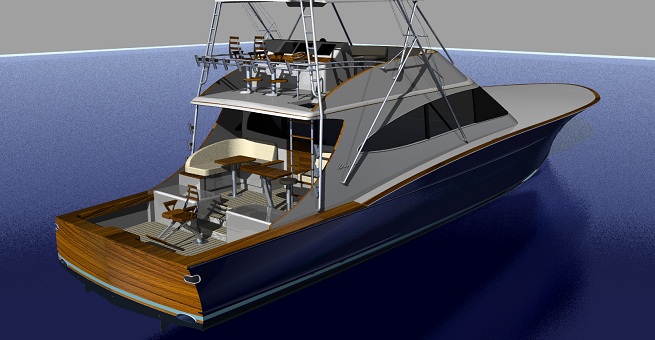

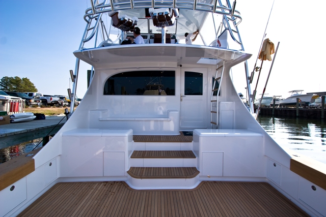

    No building and drawing, Far is working on a different "interpretation" of the design if that's the correct wording. Here's a previous version of the two-level mezzanine with the seperate "viewing area" under the cockpit overhang and teak!

  4. Capt J
    14,842
    The aft facing ladder seems to make a lot of sense, since when you're running, your body is pushed towards the ladder instead of away from it. The boat is very nice, but needs a little teak to dress it up....hehehe....

    Hey, it's got a teak helm pod, isn't that enough? :D

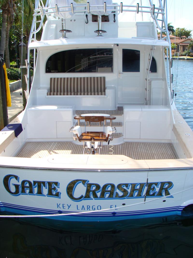

  6. Capt Ralph
    14,335
    We have learned the hard way; Even this pod is to much teak. I long for a plastic boat with a good non-skid that can be repeated. It always looks great on another boat.
    With just cap rails aft and counter trim in PH and bridge, We have TOO MUCH teak.
    Centerfolds always look gre.... Darn,, wrong forum again...

    G'day guys,
    Sorry about the delay, and thanks for the comments! The staircase on the starboard would look nice, but the cut out was taking up to much room on the flybridge, and would have to decrease the size of the console. Or increase the flybridge width - then cabin - then hull (effect the performance). Maybe on a bigger boat (the render is a 64'). But I'll second Bill's thoughts, the second lounge is still in play. Also, I haven't taken up any space in the saloon. Teak does looks great, but up to the owner I guess.
    Bill, has some great innovations on his S/F's in regards to the ladder facing the way it is, and also the mezzanine with the freezers separating it from the pit.
    The concept that I did up is simply my interpretation of a modern North Carolina S/F, with Bills signatures (mezzanine is one), and Bill's underwater Specs :D. I tell you what though, N/C stems are hard to get a good one just right!
    We have also, done up a huge 129' S/F (Ranger), the mezzanine lounge area is huge with a bar table over looking the pit, and the pit itself is huge! If there's any interests I can put a render of that up too?

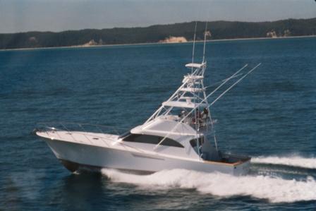

    I quite like the back layout on Amokura, simple, useable in rough seas, and lots of lounging space. Less sold on the ladders to the flybridge, but thats just probably something you get used to.
    Amokura Fishing Charters - Lake Macquarie : Cairns : Port Stephens : Sydney

    I actually did some work for Martin back in the day, I help build a joint project called Eagle (attached). Anyway, great builder, I still think his best work was Assegai, a little 46'.
    Yeah I've always wondered about those ladders up to the bridge, also height of transom as well. The lounge area is great... I wouldn't say practical, but I think the donks are below it, so that's all they could really do (thats hear say though). I heard they put the motors further back towards the transom...? Cheers

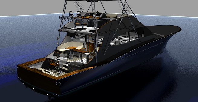

    Just a couple of changes, I've added a table on the port, and sqeezed in a bar on the starboard. (Day/Night)
    She's looking very practical all of a sudden :D. Cheers

    Nice work Far!
    I'm not convinced about the table on the mezz. I'd use the space to recline the mezz seat back further.
    Its amazing how many boats have that seat upright ...

    With eight coats of epoxy and 25 coats of UV clear Alexseal it's nearly "plastic" now for all intents and purposes! Usually get at least 5 years of service before needing any attention without a cover and then it's just a quick scuff and spray of an additional coat or two of clear to reset the clock.
    Agree wholeheartedly on repeatable non-skid, it's almost impossible to repair or repaint patterns. I prefer sprayed with particles and "break points" or slick trim lines breaking up larger areas so small repairs won't require complete repaints.

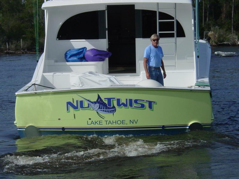

    Alas, all I have right now is one with me in the cockpit and I HOPE Carl doesn't pick it! I'll have to dig through the archives and see if there are more suitable entries. Maiden voyage/sea trial/delivery leaving here for Isla Mujeres Mexico.

    Just a little puff when putting a little lever in rewind to spin around, a late snowbird passing down the ditch just off the bow. We did roll some smoke when we hit the big pond though! Left the dock here about 10 and pulled in to Hilton Head at dusk cruising 40 knots most of the way @ 1975 turns.
