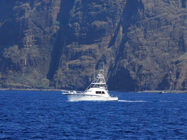

    Good luck when you go! I found this link of the one I fished on, trolling for marlin (yes) just off the high sea cliff of Cabo Girao, Madeira:

    Terrific!
    Thanks for the post. Just proves how good the 53 Hatt design is, wherever there are fish and serious fishermen there are these boats!

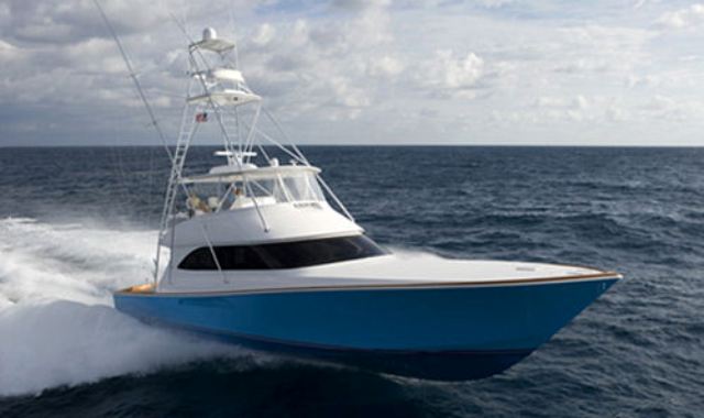

    My favorite SF boats at the moment, are the Spencer IPS types, especially the new Spencer 57 IPS with the open flybridge and tunatower. By watching the system capability of the Volvo IPS in the sportfishing mode, I am wondering, why this system is not used more often. Are you guys to conservative or to traditional, or is conventional SF with shaft and rudder the better system?

    Spencer 57 IPS

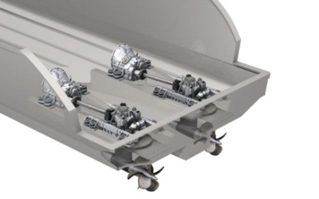

    IPS or 'pod" drives have slowly started to creep into the SF arena, with Paul Spencer being one of the pioneers. I have been on a Spencer IPS powered boat and the handling is amazing.
    IMO some of the reasons that you are not seeing a more manufacturers switch to pod drives in the larger SF market (60+) are as follows:
    We are a traditional bunch, the "if it ain't broke, don't fix it" mentality definitely applies to a large portion of the SF crowd.
    In the case of larger SF's, you would need 3, maybe 4 pod drives in order to achieve the same performance as with the traditional heavy iron. Now, there are a few examples (Betsy/Scandalous) out there of this type of set up, but I imagine the idea of maintaining 3-4 engines and drive systems weighs heavily on a Capts head.
    SF's are known to travel quite a bit, service/mechanics are a top priority for these boats. I'm not positive, but I doubt the pods have a service network that can rival a manufacturer such as CAT.
    Some die-hards will doubt the "fish raising" capability of pods until they have proven themselves without a doubt on the tournament circuit.
    Reliability/safety, again, pods need to prove themselves
    All in all I think the pod drives are a neat idea. If they would develop a pod drive that can handle the increased HP of today's large SFs then I would definitely put them on my list to sea trial. I've heard rumors that CAT is developing their own version, should be something to keep an eye out for.

    In my opinion:
    First and foremost, you will not have the fastest SF on the block with pods. You may burn less fuel, but you will always be looking at someone else's transom.
    If you drop down in hp for a conventional set-up to match the lower speeds attained by pods, cost will become an issue for pods as all those features will add $$$.
    There are plenty of realatively small thru-hulls/openings in your hull bottom, but no one really likes the idea of 2/3/4 really big openings in your hull bottom.
    Underwater exhaust, even though you by-pass some at low rpms. Some people will prefer transom exhaust and no diesel exhasut in the trolling wake.
    And finally, how much maneuverability is trully necessary? Is the boat catching the fish or the angler, or probably some combination thereof.So there in lies the rub, with conventional shaft drives an experienced captain can still outpace an exprienced angler on any size fish. It is still called "sportfishing".

    I do understand your point with the cervice network on Volvo Pentas in the US and also I am very infected by the IPS virus, due to our own IPS project, I still have some concern about ripping a complete drive off and flooding the engine room. But is the Spencer 57 with a topspeed of above 35 Kts, not fast enough? And is not a great redundency, to have 4 engines down below :).
    Given the above points, how about Zeus Pods with Cat engines and transom exhausts ?

    There is alternative drives to Volvo IPS or ZF Zeus pods coming from a manufecterer in Germany, cant remember the name. Anyways these pods where used on a new 29 meter Maiora past Summer and there production range can take up to 2600hp with bigger versions available on order.

    I was running a yacht down to St. Thomas. A 58' Meridian with a seakeeper and IPS drives was pretty much on the same route and we'd end up at the same stops. They bumped a log at just under 8 knots. It sheered 2 of the bolts off of the portside pod, and the pod was hanging on by threads. If they were going a little faster, they would've lost the drive in the deep blue sea and been sitting around waiting for a drive to be shipped to St. Thomas. No water was leaking inside the boat, they even removed the drive completely with the vessel in the water with a lift bag and they didn't have water leaking in either.
    The Spencer 57 is sort of fast enough, BUT nobody wants to maintain 4 engines and 4 drives. Never. Plus the pods really shine on a twin pod installation over a straight drive installation in fuel economy, after that, the 3rd and 4th engine and drive have diminishing returns where the fuel savings don't outweigh the hassles of maintaining everything. If the boat is going to be doing a lot of down island travelling or central/south america stuff I would definately prefer straight drives.
    I would much much rather have Zues if I was going that route, if not for the transom exhaust alone on a SF. I also would prefer the Cummins parts cost, dealer network, and dealer customer service over Volvo. And, every Volvo boat (non IPS) I've ever managed always had weird issues that were very hard for the dealer to diagnose and took multiple trips to fix. A 50' F+S was next to us at Atlantis with IPS and the amount of wash underneath the cockpit sides and transom was unreal, and would make bottom fishing with the engines running well a nightmare.
    HTM-You don't want underwater exhaust when fishing because it makes the wash off of the boat too cloudy and the fish cannot see the baits to eat them.

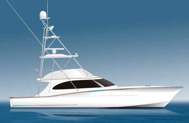

    Medium sized SF
    From what I have learned from your arguments, this must be then the ideal owner operated medium sized sportfish with pod drives.
    Viking 60 SF with open flybridge and tunatower. 2 x Caterpillar C 32 ACERT, 1200 bhp each, 2 x ZF 4000 Pod drive with stern exhausts.

    As with anything, the bigger the boat and the better the hull design and build construction, the better the ride. That 75' Jim Smith made 4-6'ers feel like 2' in a 40' Cabo at speed. As the seas grow though, you're going to start slowing down at some point in the larger boats as well......
  18. Capt J
    14,887
    HTM- Yeah that would be about ideal for a pod driven SF. But the ZF pods aren't as smooth and have the finesse in docking maneuvers as either the zues or ips.
    Most of the SF have no bow rail simply for looks. But nobody is going out on the bow at speed and few SF anchor except maybe once a year. If you notice the Viking pictured has no anchor windless pictured.
    65' is probably the largest you see an owner operator running themselves. 55-60' is a bit common. On a SF you have to get to around 60' to have the storage, freezer space for bait and food, and etc to really travel and fish for an extended period.
    Outriggers- they are deployed at about a 60 degree angle from the side of the boat. They usually have 600lb monofiliment running up the outrigger and to the cockpit with adjustable release clips on them that you can pull up and down from the cockpit. An outrigger on a 60' boat will have at least 2 release clips sometimes 3. You will put you're bait out at the desired distance behind the boat, pull the release clip down to the cockpit, hook your fishing line to the release clip, pull the clip up the outrigger, and this will keep your long line further out the side of the boat 40-60', then the next release clip will keep your line 20' out the side of the boat.......so basically it spreads the lines away from each other so your fishing lines don't tangle. When a fish takes the bait, it pulls the line out of the release clip, and your fighting the fish from the rod only.
