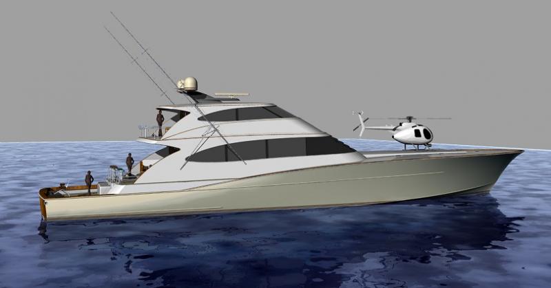

    Ranger - 129'. I'm still a little surprised American's haven't gone bigger with there S/F's. Imagine running your clients out via heli to a mothership for the day/weekend for a spot of fishing. :D
    Far
  10. Patudo
    Patudo New Member
    Dec 28, 2011
    17
    Eastern Atlantic, South East Asia
    When you get into that sort of size a mothership/sportfisher operation becomes very compelling. Big comfortable vessel to live on and a smaller vessel optimized for sportfishing to actually fish on.

    Patudo, any S/F boat of Ranger's size that has been built, has been built in Alloy, and resembles something else other than a S/F. The idea with Ranger was to resemble a S/F, and have the performance of a S/F (size considered), and also have qualities of a mothership. Personally, I'd buy the boat purely on merrit on how the boat looks, like mosts S/F. I love the way S/F's look and perform, but how unpractical the boats are becoming to make sure they bring in the fish... well there's no surprise the market is fairing off to put it lightly.
