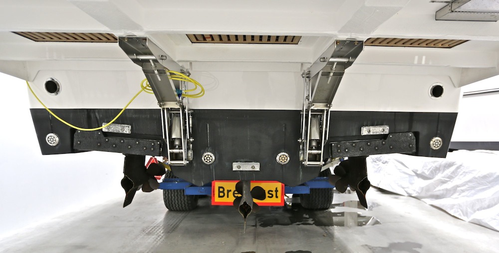

  8. AMG
    5,392
    I don´t have the size figures available, but in the 54/60 they are fitted and filling the end of shallow tunnels where also the prop wash is channelled. Both the 54 and 80 hulls are designed for IPS with a slightly lifting trim so the interceptors can trim down the bow. Since both have long water lines and pretty sharp entries, they actually run smoother with the bow trimmed down also at high speeds. These boats also have Seakeepers to keep them stable in lower speeds.

  10. mapism
    mapism Senior Member
    Aug 9, 2008
    2,292
    Sardinia
    Do you mean that the blade shape is rounded to follow the upper profile of the tunnels?
    I've seen Humphree's interceptors with a blade profile that follows the lifting rails, but never a rounded one meant to follow prop tunnels.
    I tried to google for some 54/60 stern photo on the hard, but couldn't find any.
    Do you possibly have one (or a drawing) that you don't mind publishing?

  12. AMG
    5,392
    The IPS are fitted on flat tunnels...
  13. mapism
    Aug 9, 2008
    2,292
    Sardinia
    Very interesting, thanks.
