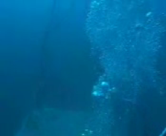

    I just saw the video, Thank You. I am completely in shock after seeing the video in entirety.
    The entire foredeck is just gone, yet the joinery inside the salon looks un-touched. The transom is gone and the deck hatches are all gone, but the engine room looks pretty un-touched. Here are some things I noticed.
    It appears to me that the outer layer of fiberglass is pretty thin. (However I am not a boat builder). To me, it looks like the boat was built very light. Especially compared to the Viking SF pictures where it hit a whale and it showed the layers of glass peeled off of the coring.
    There are area's where the fiberglass is intact on both the inside and outside skin, but the coring is completely gone from about a foot of the inside of it. Almost as if the coring disintegrated leaving the two outer skins to hold everything together.
    Does anyone know if the hull of the Bertram is solid glass and the hull sides are cored, or is the entire hull cored? The hull sides seem to be broken off or severed at the same height pretty much all of the way around. Could this be from where the coring starts......say 12" above waterline?
    The transom broke right behind the bulkhead on the side, but the outer fiberglass skin is cracked in many areas on the transom.
    There were some deep up and down gouges in the bottom paint on the starboard exhaust that I found to look strange. Almost like abraison from a cable.
    Could the vessel being subjected to freezing temperatures in the winter, have an effect on the core's integrity or it's adhesion to the fiberglass skin?
    There is no way this delamination occured under-water while it was sitting on the ocean floor.
    Was the boat surveyed prior to purchase? Did it find any issues such as bulkhead tabbing?
    To me, the theory of the core gassing off and causing adhesion issues between it and the outer fiberglass makes the most sense. I really doubt a hit from a 200lb buoy would do this, a shipping container yes, BUT the damage is too elevated to think shipping container.

    There will be a point of transference between the two as both are involved in the entirety of the vessel. There are multiple types of delamination involved. In the case of where the glass delaminated from the core, it'll be hard to determine exactly where one stops and the other picks up after this much time under water. However, that's not the delamination that catches my eye. What I also observe in a few places is delamination of fiberglass layers from each other, and that should not be able to be inflicted ever. It means there were some issues in the layup. I also saw fiberglass joints on the bulkheads that popped off clean rather than tearing out the glass which means the joint didn't meet it's engineered strength or adhesion. Everything I see about the damage on this boat just says to me "hot mix". That's just my gut feeling, but my gut has been fed a steady diet of making and crashing fiberglass parts all of my life.

    As I have also been in offshore racing I have seen boats crashing and split in two pieces or a hundred, much like if they had exploded, so anything is possible when disaster has begun.
    What is strange here is the missing transom, especially since I saw on some of the last pictures that the tower was still there...? Somebody else got that impression?

    Thanks Carl – that makes fascinating watching. It will be interesting to hear the conclusions of those professionals charged with finding the cause of the sinking. In the mean time, this video does give some indication of how the transom ‘might’ have come off so cleanly.

    At one point in the video it showed the port side from where the captains controls are, all the way to the remainder of the bow. For a split second I saw a straight line as if the boat may have been sitting on its nose at some point. The only thing that throws that theory out the window possibly is the remainder of the tower. I had a thought that maybe the tower is floating in place connected only by some wiring.
    I dont know enough about these boats to recognize what the diver was showing in the engine room on top of the motor. To me it looked like some kind of small light bulb. I was wondering if someone could tell me what that might have been? Thanks
