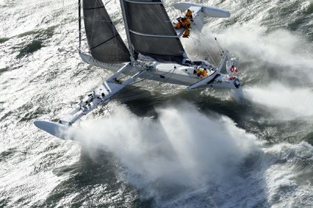

  12. Innomare
    Innomare Senior Member
    Dec 5, 2004
    233
    Hydroptere
    Tri-Star,
    you must be happy to hear that a trimaran is a very serious contender to be the first to break the 50 knot barrier (average on 500 m) for sail-powered vehicles. It's the fastest sailing boat around now for sure.
    It does have some foils under the waterline to help though. Have a look at www.hydroptere.com. Some cool videos of speeding in heavy seas.
    Everyone's going for that 50 knot barrier (in windsurfing, kiteboarding and sailing) and 2007 may just be the year that we break it.
    For the interested, the record is now in the hands of the windsurfers at 48 knots and a little something. But the kiters haven't been around for long and are approaching fast...
    Bruno
