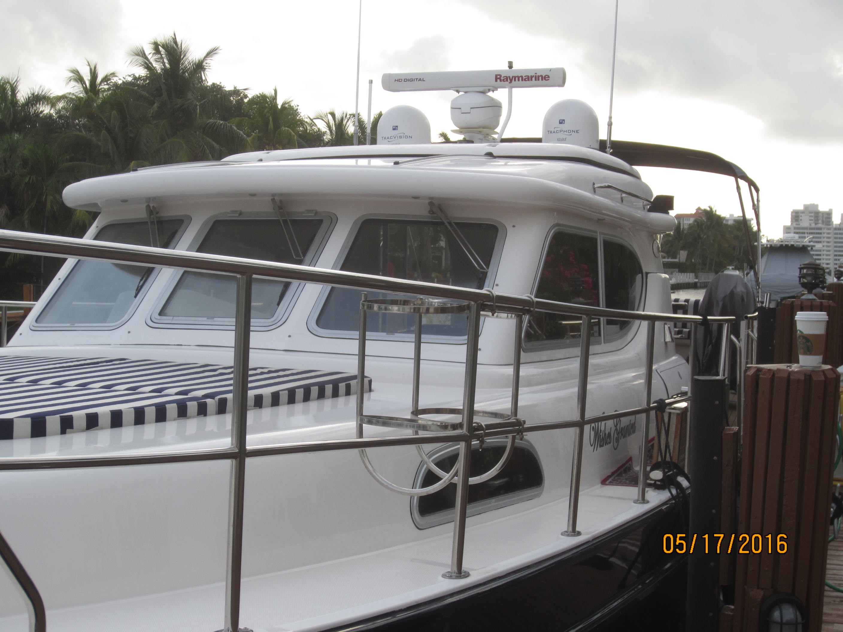

    Are there any updates on this? I've got weathered caulking topside, where wheelhouse sides meet deck (black lines in picture). Both are gel coated surfaces. Also the caulking around wheelhouse windows. This time, I want to use white.
    So is it the 4200, 4000UV, Sikaflex 295 (UV), Lifeseal, or try and find a DOW product? IMG_3909.jpg

    I like lifeseal myself and use it a lot when I am looking for less than 5200 bonding strength.
