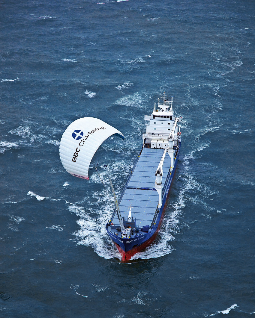

    And this kite system really works quite well. In the nineties, we have tested a large automatic kite sail system on one of our smaller single engine cargo vessels. We tested it on our Atlantic Ocean routes in the Trade Winds. When the more than 300 ft long vessel was able to catch a steady trade wind and the kite was deployed, the main engine could be retarded to idle power, just producing enough power for the shaft generator and the vessel could maintain its cruise speed. With stronger trade winds, the main engine could even be shut down and the variable pitch prop could power the shaft generator in the dragging mode.
    But the system made only really sense on long steady tail wind routes. Tacking upwind, the system was not worse the effort. But the degree of automation of the sail steering was not at todays standard. Under the line and at that time, for a commercial cargo vessel, the system was to expensive and to complicated to operate and there were not enough fuel savings for a commercial vessel travelling under shedule but for a private yacht, I would really concider one of these systems.

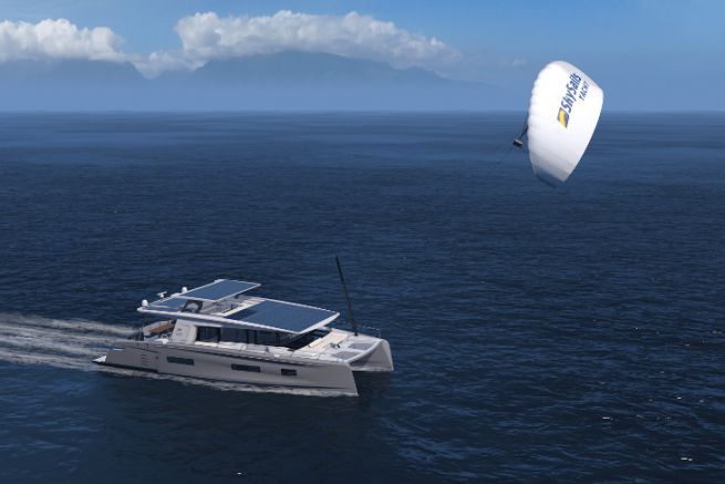

    IMHO, this electrical boat setup would nicely fit into a large sailing catamaran like for example the Lagoon 77. Here the solar panels could cover most of the hotel load and even assist in silent docking. And the standard sailing rig of a saling catamaran is proven technology.

    Here are the two examples, cargo vessel and silent yacht
